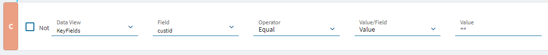

To get around this, I have checked if one of the KeyFields is empty:
Great idea, thanks Jonathan.
