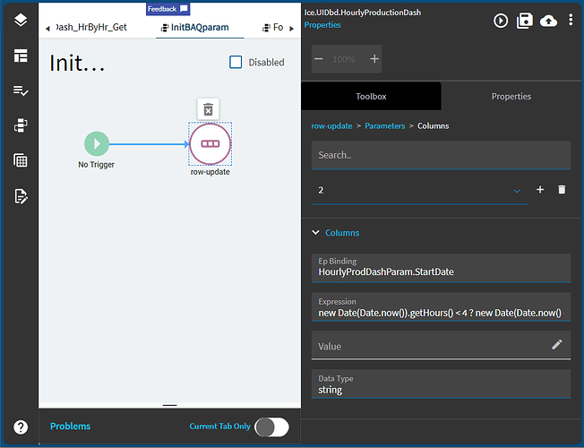

I am attempting to build a dashboard from scratch, the pre-built tool won’t work in this instance.
I have the following row update:
the expression is new Date(Date.now()).getHours() < 4 ? new Date(Date.now() - (8 * 24 * 60 * 60 * 1000)).toISOString().split(‘T’)[0] : new Date(Date.now() - (7 * 24 * 60 * 60 * 1000)).toISOString().split(‘T’)[0]
This correctly sets a string, but when I attempt to set a ‘date’ or ‘datetime’ Data Type, it isn’t updated in the data view.

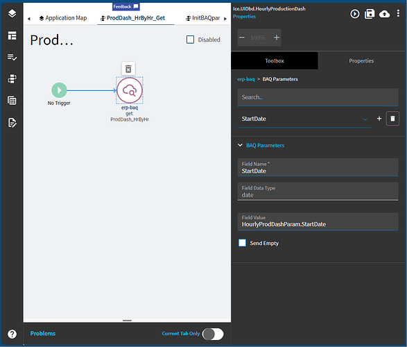

My population event:
treats the ‘string’ as null because it’s looking for a date.
Does anyone have a suggestion as to what I am doing wrong?

Working with dates in the browser, I’ve had the best luck adding “T00:00:00” to the end:
2024-05-07T00:00:00
Otherwise, it doesn’t recognize things properly - sometimes uses wrong date, sometimes ignores my input altogether
Kevin,
Since you are using a BAQ, I recommend that when you’re in the BAQ designer, just add a new calculated field to handle this date conversion.
Here’s how to set it up:
  • Create a Calculation Expression: Just drop in the Date() function to strip off the time part from your DateTime field. You’ll write it like this:
                   `Date(YourDateTimeField)`
    This will get you just the date, nice and clean.
  • Use Your New Calculated Field: Now that you’ve got this handy calculated field, you can use it anywhere in your BAQ outputs or for other calculations you need to do.
I hope it helps.
Hila
