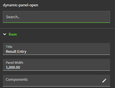

At this point I noticed something different about the dynamic panel within InspResultsEntry. The ResultsEntry.EnterResultsPanelTool event in Application Studio did a row-update, setting a TransView.DynamicFileContents field to the value of InspPlanSampleLst.SpecRevDynamicPanelContents which made enough sense. But looking at the dynamic panel itself, there is nothing in the Components field where you would expect to see a field or value.
On the other hand, when I tried this same logic, I was met with a completely blank panel. I attempted to pass the parameter of TransView.DynamicFileContents that held the result of my function, and even tried passing the function result directly to the function. Unfortunately, both of these were met with the error message, "Cannot assign to read only property '0' of string '{TransView.DynamicFileContents}'". This sounds like it’s trying to parse through the string name of the variable as an array instead of treating it like an actual variable.
I did try prepending it with question marks like some locations in Application Studio require, but to no avail.
I tried adding the raw JSON directly into the Components field, and it was able to render how I expected it (albeit as read-only, but I’ll cross that bridge when I get to it), but naturally that does not help in creating actual dynamic fields. I confirmed using the debug tool that TransView.DynamicFileContents is indeed a valid array of objects, but I have been unsuccessful in getting the panel to understand it.
