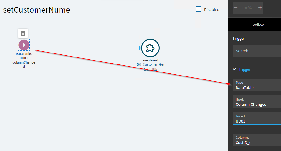

In a UD01 form (2025.1.16), I’m trying to get a customer record, so I set up this event with these arguments:
And I’m calling the event with these parameters:
I’m triggering the event with:

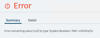

But when it hits the GetByCustID event, I get this error:

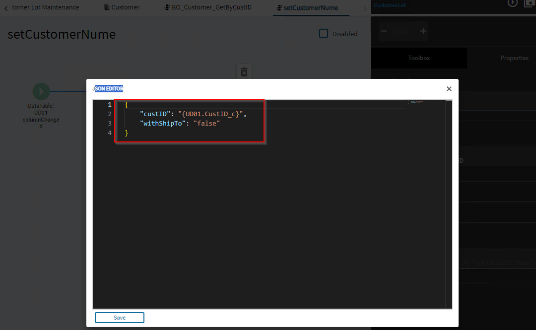

I’ve entered the withShipTo value in the JSON different ways, with and without quotes, etc., with the same resulting error message.

TDray
(Todd Dray)
2
What happens if you set withShipTo to 0?
jdtrent
(Joe D Trent)
3
Good idea. But same result. :-/
dcamlin
(David Camlin)
4
I don’t think you want quotes around “false”.

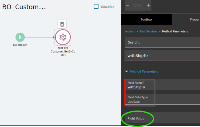

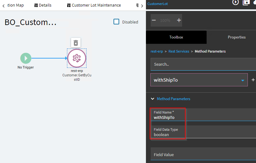

Can’t you just set the false value here, instead of trying to pass it from the event-next json?:
jdtrent
(Joe D Trent)
7
Yep, that works a lot better. Simpler that I was doing, too.
I ended up using the GetCustomer instead of GetByCustID because it doesn’t need the ship to flag.
Thanks!
