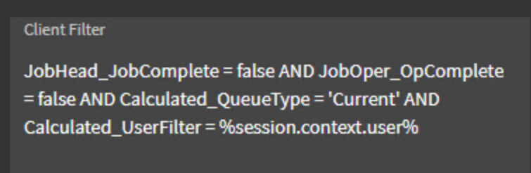

For client-side expression try %session.context.user%
If you need other user fields you can call userfile like so
that didn’t work either… all records still display:

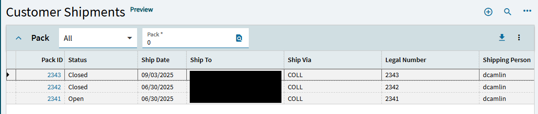

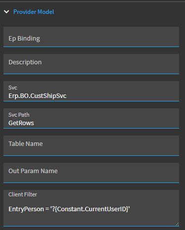

I had to find an example to play with… but this is the Client Filter in a grid Provider Model:
Have you tried using Constant.CurrentUserID ?

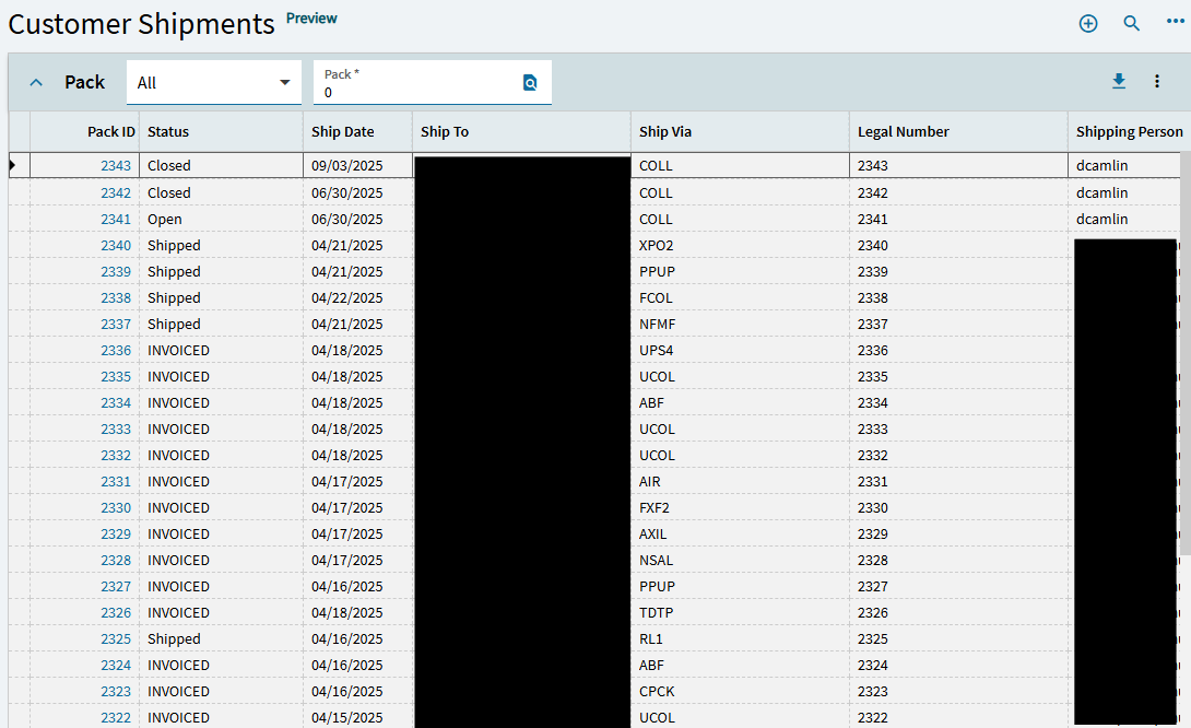

Without Filter:
With Filter:
