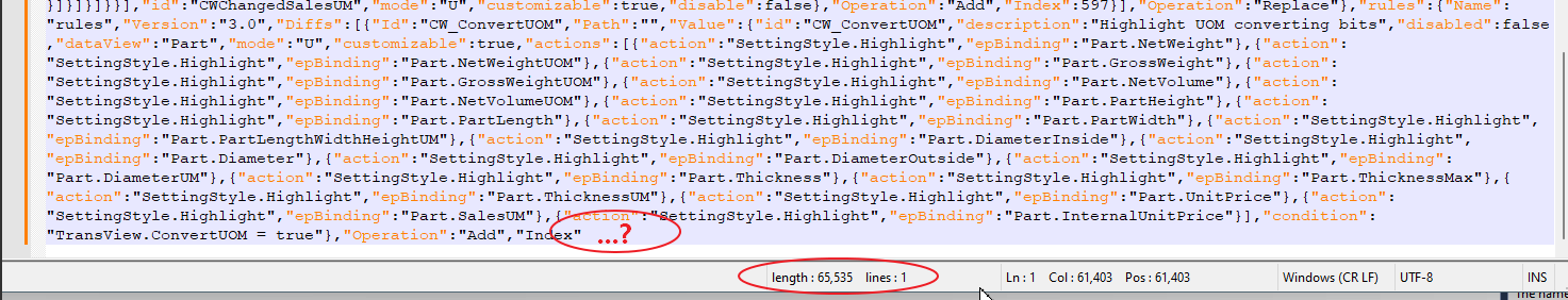

Maybe this is just an artifact of copying from sql mgmt studio column in the query results, but the character lnegth looks suspiciously like I may have exceeed syscharacter03’s capacity? Yikes.
EDIT Googling it suggests nvarchar(max)can hold 2GB, and exporting to csv and fluffing around I was able to bring in the complete json…phew.

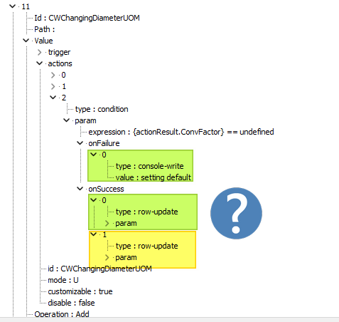

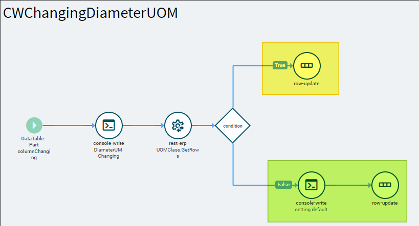

But yes its scarmbling my condition statement resultant actions:
How its supposed to work:
How it incorrectly represents it internally:
