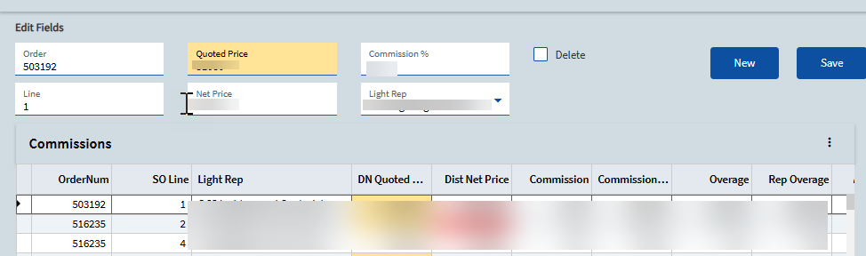

Kinetic grids are still kinda of buggy but they were worse believe it or not. We moved away from editing grids directly to using fields and functions instead of uBAQ grids.
