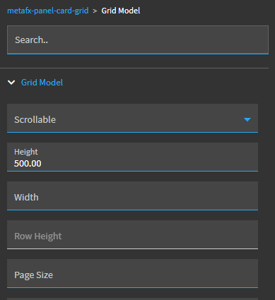

I was able to adjust grid height using panel-card > Grid Model > Height. Running 2024.2.15 on-prem
These are my settings. Worked beautifully.
Is your page type ‘Dashboard’? I suspect that is the actual cause of my problem.
Yes, page type is Dashboard.
I also have Auto Fill Container turned off. I’ve had issues with that checkbox (doesn’t return all rows when there are a lot).
