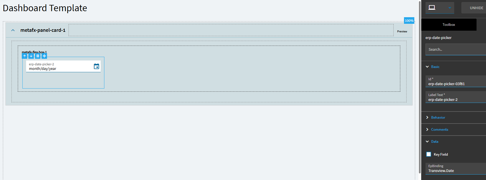

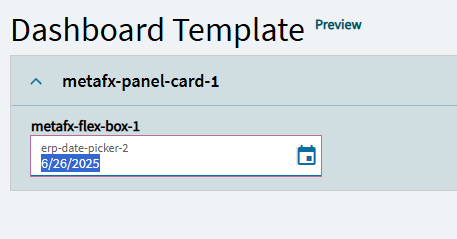

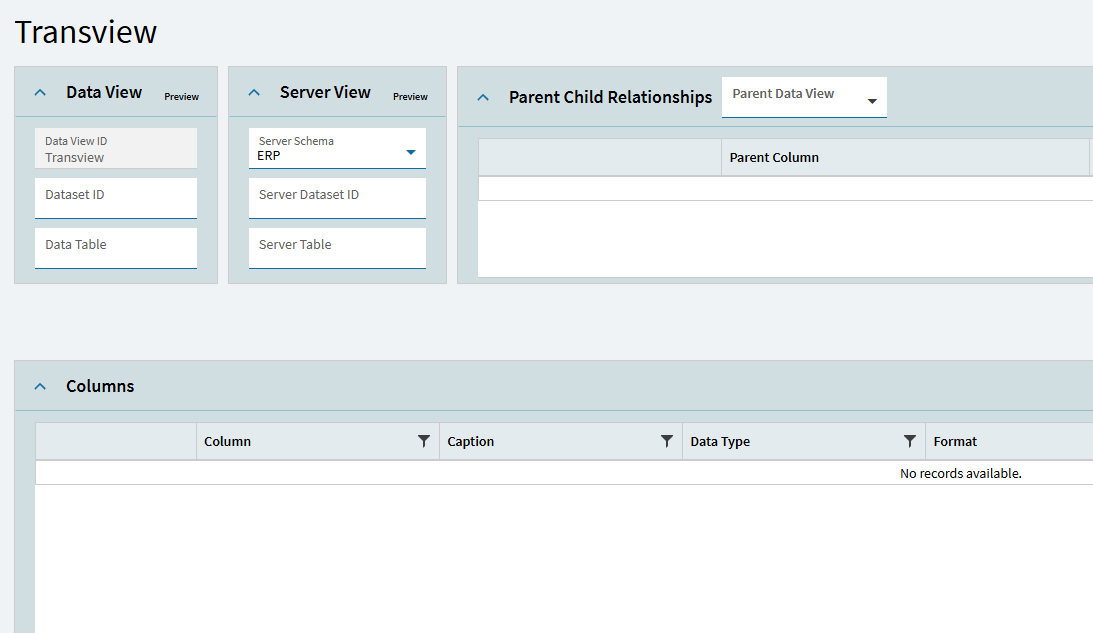

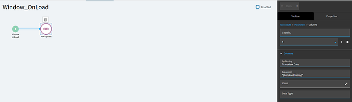

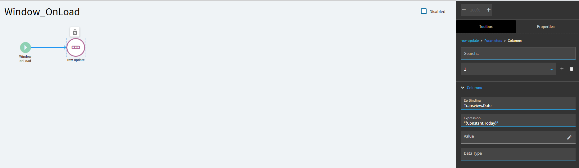

I think this is related to it being bound to the callcontextbpmdata field. Here’s what I put together and a quick example.
EDIT
As noted by @Zachariades below, these instructions work on a dashboard created without the app wizard, if you used the wizard you will need to trigger off of a different event.
Date picker control bound to Transview.Date
Empty Transview dataview
Window_onLoad event with row-update to set Transview.Date to “{Constant.Today}”
When I preview it I get today’s date populated in the date picker when it loads.
