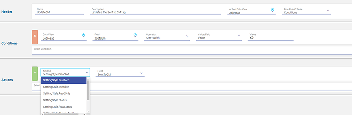

I am trying to create an Application Studio Rule to control the UI behavior of a custom tag I added (SentToCM).
The behavior is trivial to express in psuedocode:
if(JobNum.StartsWith(“X2-”))
SentToCM.Enable;
Else
SentToCM.Disable;
Here’s a screenshot of my almost working rule:
But I have run into multiple problems when trying to implement it using the Rules tab of the Application Studio.
  1. I cannot find an ‘else’ statement in the Rules. Not a big deal, I can just invert the logic of the ‘if’ statement…
  2. I cannot find a ‘Not’ operator for the Rules. Not a big deal, I can just set the default behavior of SentToCM and then change that with a rule…
  3. There is no SettingStyle.Enabled that I can find, so I’m unable to have SentToCM be disabled by default and enabled by a rule that says “JobNum StartsWith Value X2-”
  4. There is no ‘DoesNotStartWith’ operator in the Conditions, so I’m unable to have SentToCM be enabled by default and disabled by a rule that says “JobNum DoesNotStartWith Value X2-”
  5. I assume an Event might be able to help here, but trying to create a new Event crashes my browser, so that’s a no-go.
  6. I could create a new field for every job and store it in the database, a SentToCM field, then run a BPM that calculates the result and stores it in that field, then create a rule that reads from that field and disables the UI based on the result, and at this point I’m certain I’ve missed something and there’s an easier way of doing this.
My question for the community:
Is there a way to implement the above psuedocode using the Rules in the Application Studio?
I don’t think you can ,currently, implement what you are asking without using an event.

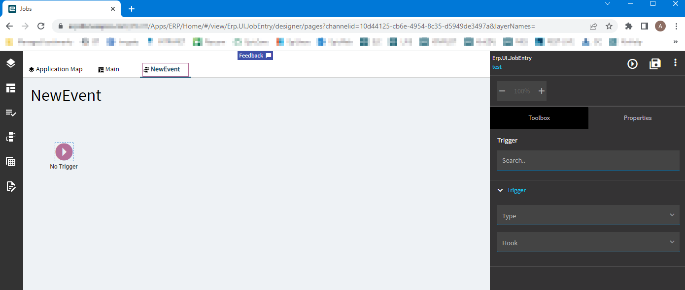

I just opened Job Entry in our 2021.2.8 testing environment in a browser, created a test layer in App Studio, and navigated to the Events sidebar and clicked on the + to create a new event. No crash on my end… Are you still on 10.2.700? Epicor might have that as a known issue, and just tell you to upgrade. You can check the release notes to see if it came up.
Lots of improvements & bug fixes in App Studio over the last 3 major releases.
