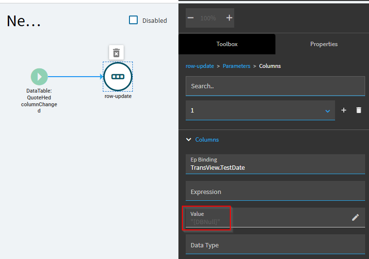

Question: How does on go about setting a datetime to null in Application studio?
I’ve tried all kinds of combinations in the expression and Value fields.
It just mostly ignores the setting unless I plug in a date there. “1/1/2024” sets okay. Just not a null.
Ideas?
Thanks,
Joe
jdtrent
(Joe D Trent)
2
Well, you try one more thing:
jdtrent
(Joe D Trent)
3
And evidently don’t need the value. Only the data type.
Randy
(Randy Stulce)
4
Sorry for the Necro but I wanted to thank you as this saved me today!
