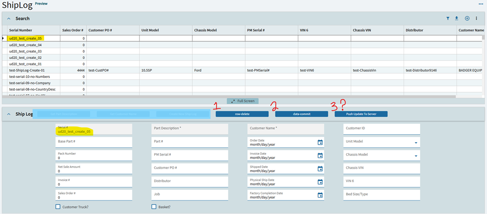

Right now, this is my setup. The user lands on the landing page selects a record.

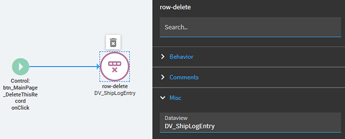

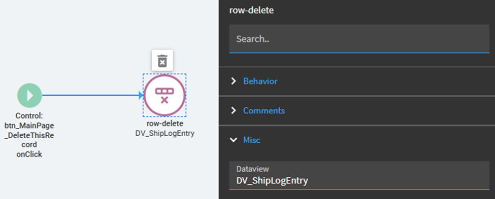

(1) I click the row-delete button. Ud20_test_create_05 gets deleted from the DataView. The resulting DataView is dirty (in red).

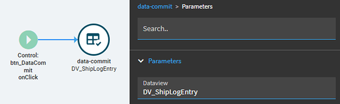

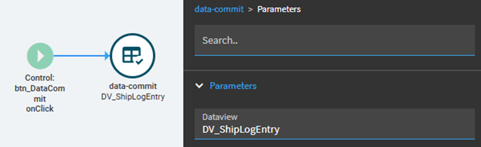

(2) I click the data-commit to un-dirty the view.

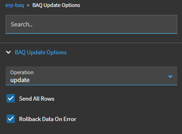

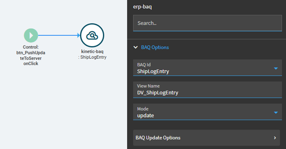

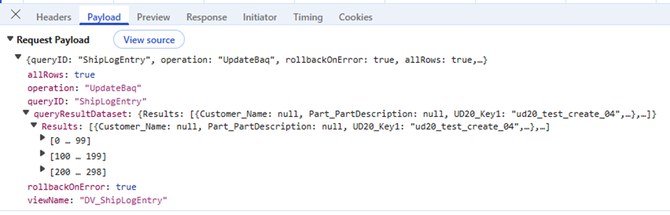

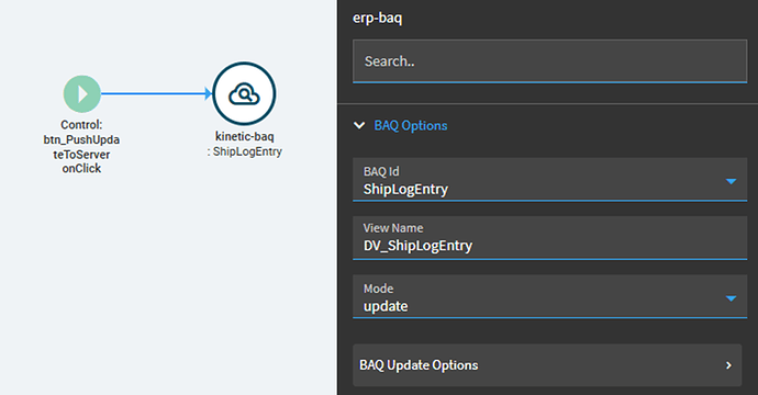

(3) How do I push the updated DataView to the database? This is what I tried, but I can still see ud20_test_create_05 record in the database.

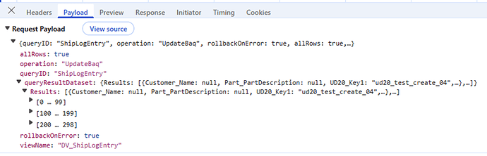

This is the payload on the request.
To summarize, manipulating the DataView is easy but I cannot get the changes to reflect in Kinetic. =/
