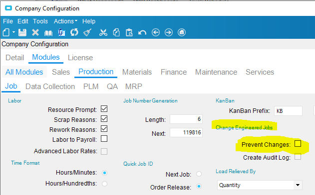

I know this is not really an answer to what you asked, but what is your setting here on Company Config?
I have not tried App Studio customizations yet (I mean barely, but not really), so I want to leave room for the real possibility of some way to accomplish what you want without changing company settings.
Having said that, I wonder if changing that setting is enough to get you by?
The Prevent Changes checkbox is True, and I need that to remain. I need to have a checkbox that can be checked to trigger the engineered and released buttons to be read only. The goal is to be able to lock jobs and prevent changes during compliance reviews.

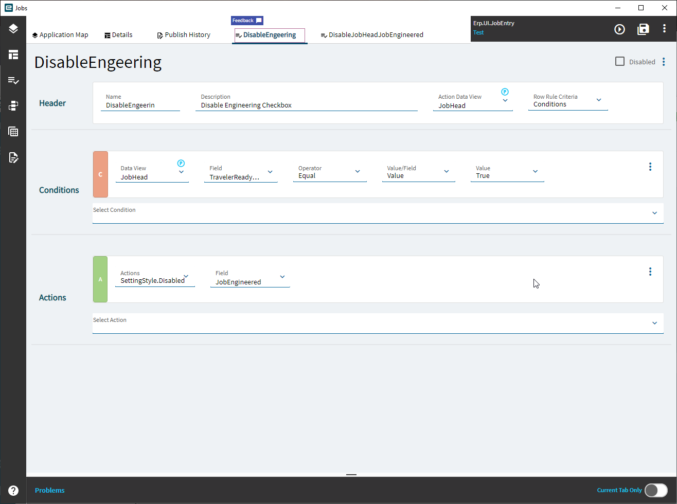

Look at Data Rules in App Studio. You can’t edit the default ones so you’d need to add your own, but there is one called DisableJobHeadJobEngineered that controls when that checkbox is read-only. You’d just add another rule for when the field you specify is true, the action would be to set the Engineered checkbox to disabled.
I wired this one up to the Mass Print checkbox just because it was already on the form, but this disables the Engineered checkbox if Mass Print is selected. You’d do the same for the Released checkbox.

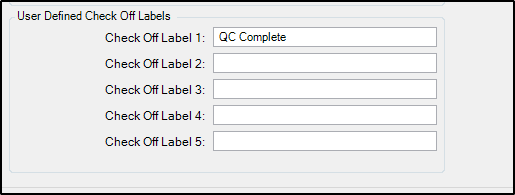

Depending on what you want to use the checkbox for there are a few built in ones that should work for what you are describing. Look at the fields jobHead.CheckOff1-5. These remain active when the job is engineered and released.
They are also searchable in the job status field in job search.
You can find them in Company configuration \ Modules \ Production
That’s the answer!
Works great!
