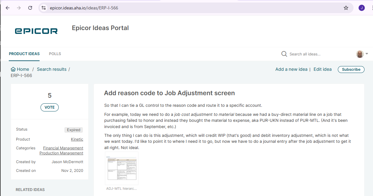

So, you are reminding me of an expired Idea I made from 2020:

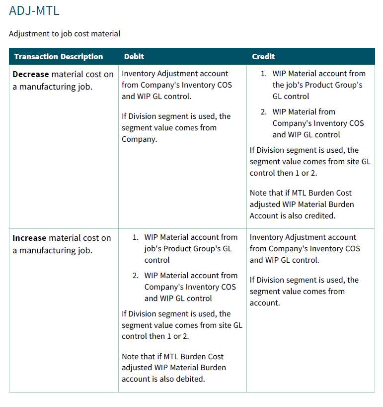

What are you saying, that the costs are not being released from WIP? You should see MFG-VAR for that if the job is closed and the month/date has been captured.
This has hit a snag for us if the WIP Cleared box is checked, for example. Let me know if I need to explain that one.
Also, you are familiar with the tech ref, right?
