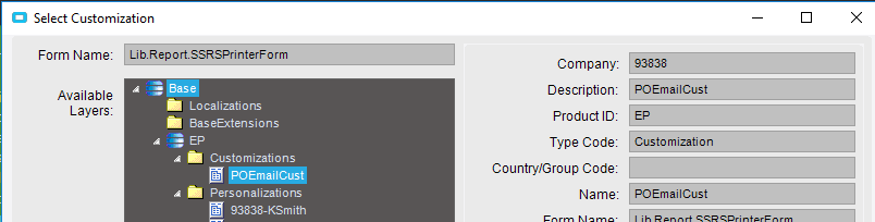

I have made this customization:
How do I apply this customization. I cannot find this object in menu maintenance.
Thanks!

What are you trying to do?
Couldn’t you customize the report form (the one that calls the email/fax settings form)?
If it is a BAQ Report, use BAQ Report designer
I am trying to add a drop down list so there you can select an email address rather than typing it in every time.
Customize the Report window by adding a field to hold the dropdown list of names. Then use a BPM to pass that along when the “output” is an email attachment.

I would assume that since this is a sub screen, that you would have to do something via Process calling maintenance. Create a menu ID with the customization applied, then create a process calling maintenance record to launch that menu item instead.
But I can’t seem to find the dll to apply the customization… The program was manually filled in, perhaps this form is not with the client?
