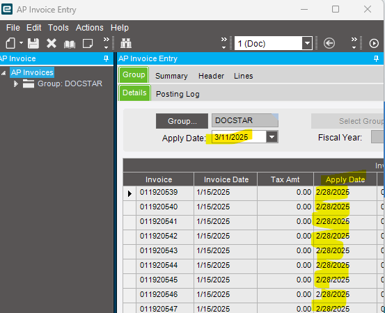

Apply date and group apply date Ap invoice entry
Is there any way i can get the same ApInvHedApplyDate which ApInvGrp apply date field has ?
Out of the box the invoice apply date can be less than or equal to the group apply date not greater.
Why do you want to change the default behaviour?
You could use a bpm to make this match. Use a trace to work out the best entry point.

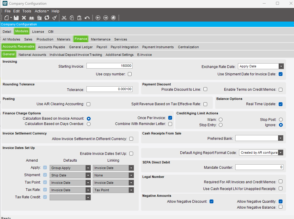

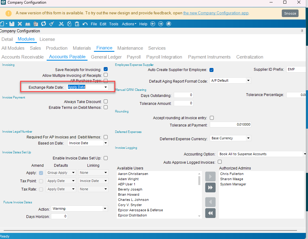

One thing to be aware of if you are using multi currency. There is a setting in the company config that allows you to select the currency date on either the apply date or the invoice date. So this might be a reason for the dates to be different.
in company configuration where i can find that setting ?
please help …
This one here.
I have apply the same setting,
can I get now group apply date and invoice apply date same?
That setting is related to what date the exchange rate calculation is taken from, it has nothing to do with automatically setting the invoice date to match the group apply date. I mentioned it purely as a potential issue.
