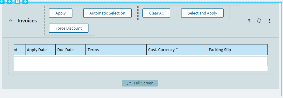

I had to add a “Packing Slip” column to a grid view and I need slide it over a few columns. I can drag the column over to where I want it in App studio, but when I save my layer the columns position isn’t saved and just goes back to the default/right end of the grid view when I reopen it. I don’t see anything in grid model that allows me to reorder columns, it seems like it is stuck in the order they are created when adding the column. I know that in Kinetic view a user can simply drag the column to where they want it and “save layout”, but we don’t want every single user to have to do that. I need to be able to save column order from within when creating the layer in App Studio.

Soo… has anyone confirmed this is working in 2022.2? I am trying to do that and it’s not sticking. I see it changed in app studio, but nothing is changed when I use the form.
I had to log out and log back in.
