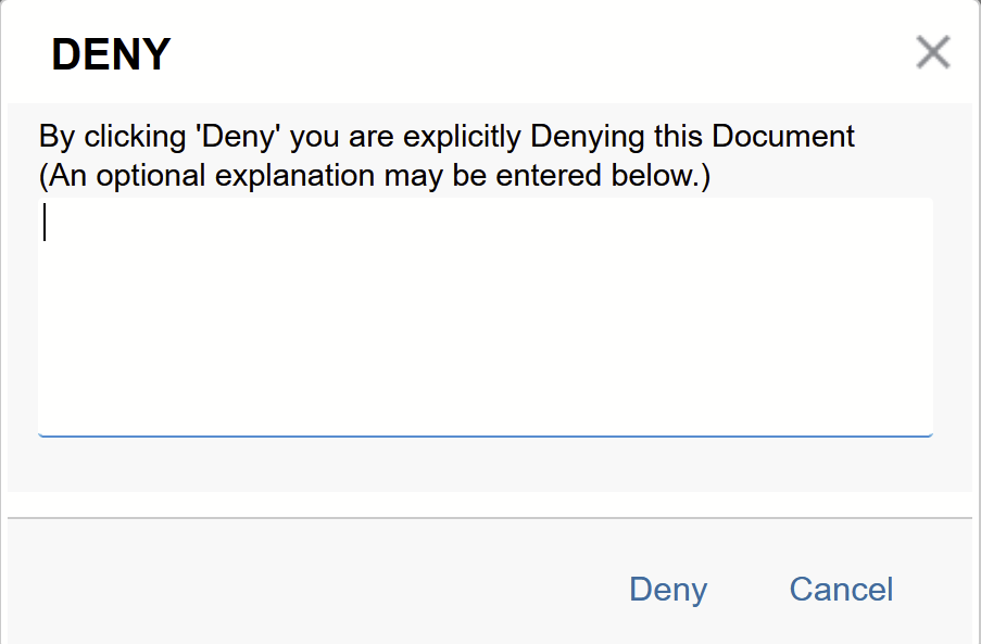

I am trying to set up a rejection workflow for a customer - they want to be able to reject incorrectly indexed invoices back to whoever submitted them. I’ve leveraged the $Is Denied property to catch and reroute documents. However, I’d love to be able to use what is typed in the box that appears when you click Deny further in the workflow (like putting it in a big stamp or a Display Message, etc)
I know the comment shows in history but they won’t want to scroll down to find it. It doesn’t appear to go in any system field I can see that I could reference elsewhere.
I believe the field is AAAA0001.dbo.Approval.Reason - but I cannot find anywhere it’s available for use.

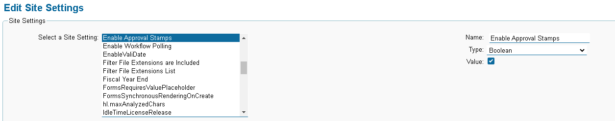

I’m not sure if you’re looking for more than this, but I believe that this Site Setting will instead prompt the user to enter their comments in the stamp and that then becomes an annotation on the document.
But doesn’t that get 2 pop ups, my client asked for this to be switched off for this reason. I have posted a betterizer to get access to these comments from a direct field
