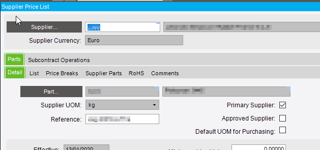

I need to apply a changelog to monitor any Suppliers being added/removed from Approved Supplier.
Within the Supplier Pricelist there is an ‘Approved Supplier’ Boolean. I need to monitor if this is ticked / unticked. However I know this is a view and so I am unsure where to apply my changelog
Can anyone offer any assistance please?

It looks like Approved Supplier isn’t explicitly stored anywhere. But rather that if an entry exists in AprvVend, then it is shows as true. (Approved Supplier is checked).
Un-checking that box deletes the related record in AprvVend.
So a change log won’t work. You’ll need to either have:
  1. A BPM to email you when A record in AprvVend is created or deleted
  2. A BPM to create an entry in a UD table to log the Addition or deletion of the AprvVend record.
