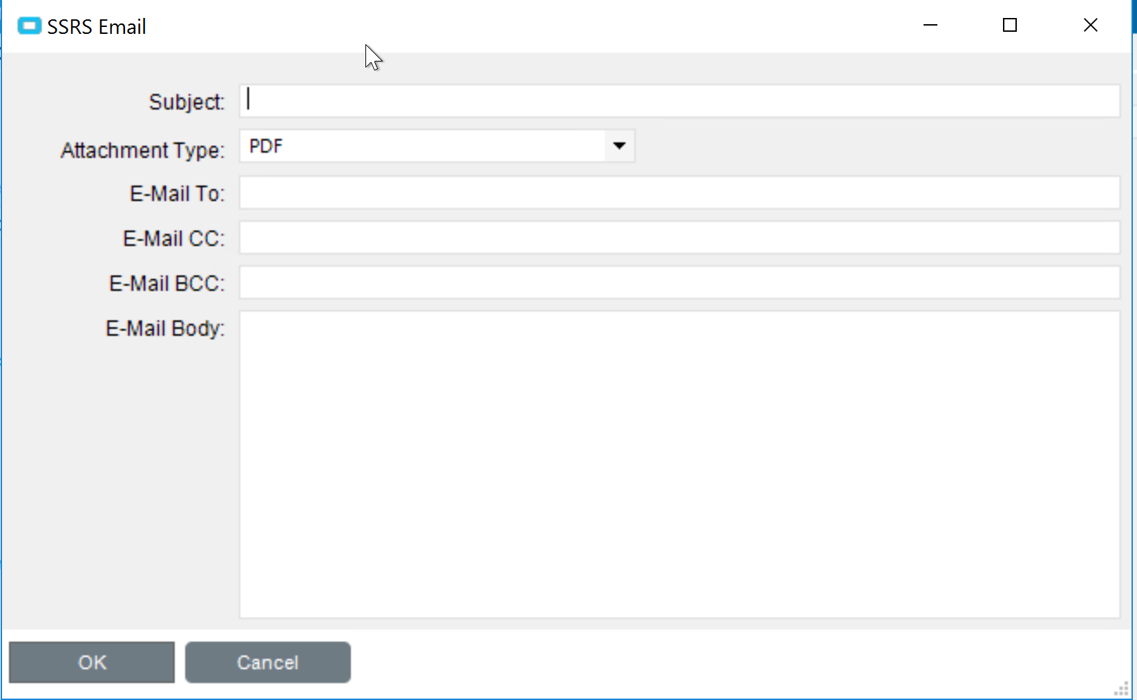

What I’m trying to do is that when you click the print preview button it will send automatically the report, rather I want to be able to see the Epicor Email screen (from the routing) to confirm all fields are good or to modify as needed, if that is the case:
I think this is the second time in as many weeks that I’ve had to admit it’s been a hot minute since I built a APR workflow, but I’m pretty sure they place the emphasis on automated. You turn on routing, it does the rest without any option for further input. Hence my suggestion to just send yourself a copy.
All of my email automation projects completed this year have been through scheduled functions, FYI. That’s all internal alert stuff though. To the extent that is relevant, I’ll add that I don’t deal with OOO or forwarding at the ERP level. That’s what Outlook (or whatever email service you use) is for.
