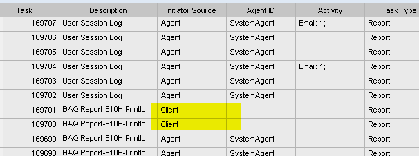

But the InitiatorSource field can be used to determine if this was initialed by the email button vs a break route.
The following highlighted ones are from the Email button.

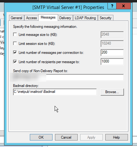

Check the badmail directory? Also configure the NDR address.
I checked Badmail folder, nothing in there. I added my email address to the NDR parameter and tried to send another to the same address but still receive no feedback. Any other parameters I should be looking at for getting email feedback that cannot be sent because domain doesn’t exist (assuming gmailcom is an invalid domain).

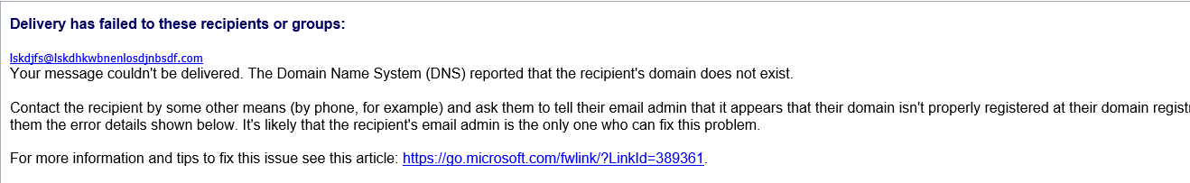

Just for clarification you tested a successful email via the relay? Honestly I am surprised that the relay even accepted an email with no TLD at all. Try sending a test to something wild like lskdjfs@lskdhkwbnenlosdjnbsdf.com
Using that it appears to have worked:
I can also locate this in O365 message tracking. I wonder why the other email (Tanner@gmailcom) doesn’t give me any information back. I guess I’ll have to wait it out. Also might have to start using regular expressions on email address entry in epicor :frowning:
