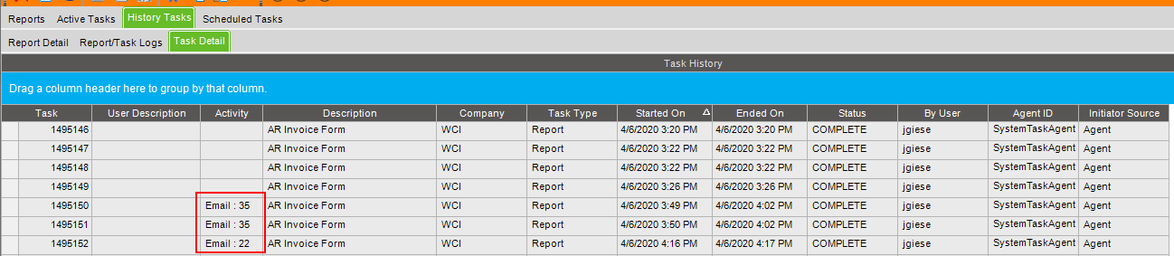

For the sake of argument, one could potentially look at the resulting SysTask record which typically includes the number of emails sent. It’s cumbersome and not a great approach, but might be useful in a pinch.
I already am breaking the invoice group down into one invoice per SysTask so that might prove useful. What field indicates the number of emails sent? Do you happen to know what causes the value to increase?
I am not sure, I never really paid much attention but I did note in the description it said something like "email: 4 " or similar
It’s the Activity Field.
If an APR breaking was to generate 10 emails, would just one SysTask be created with that Activity indicating “Email:10;” ?
