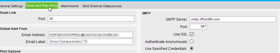

We use these setting in epicor - which havent changed…
