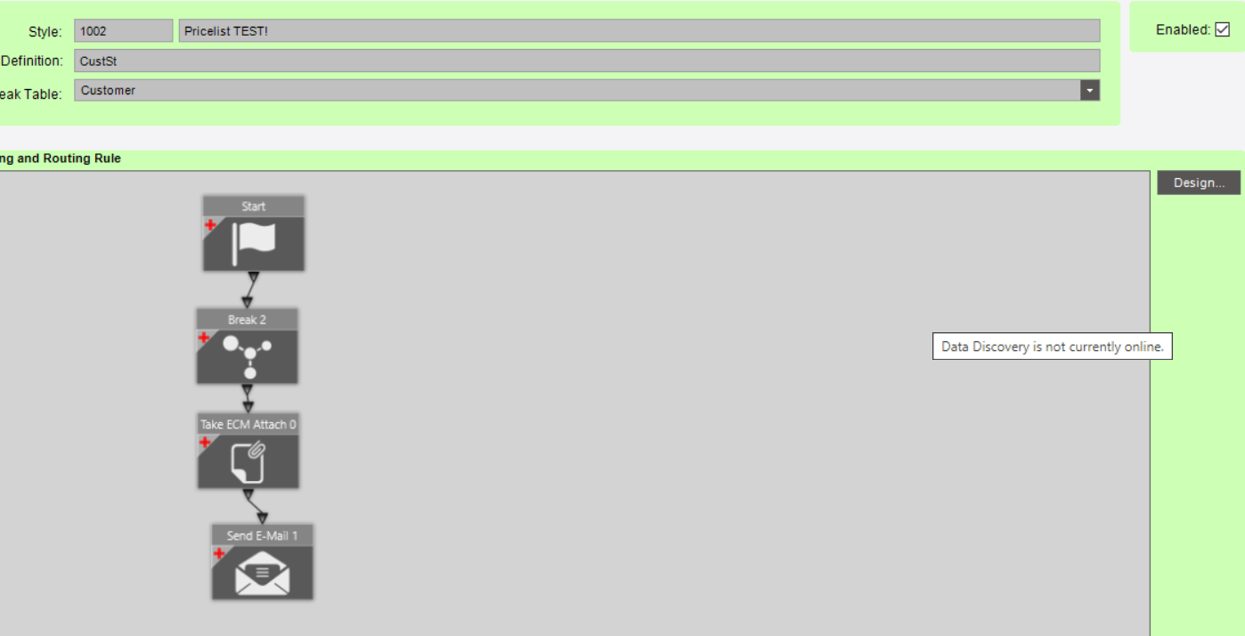

I’m trying to create a APR that can send an email with a already existing Attachment.

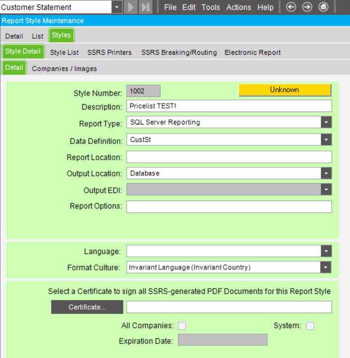

I’m just not sure how to do it. I dont want it to also send a different report, so I’m leaving Report location open. But Epicor doesn’t like this.

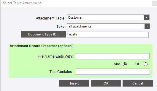

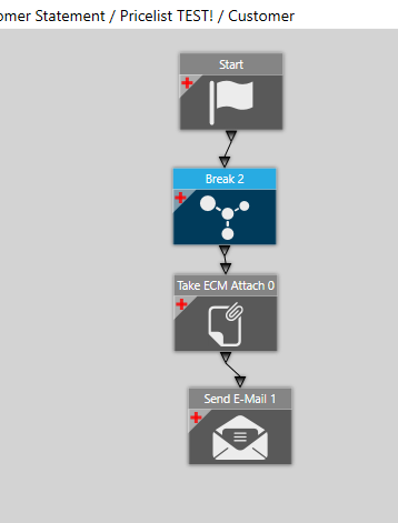

It breaks on CustNum, then takes a attachment from Attachment table Customer
using Key fields and then Custnum again

I think it is because I havent filled in a reportlocation.
