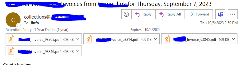

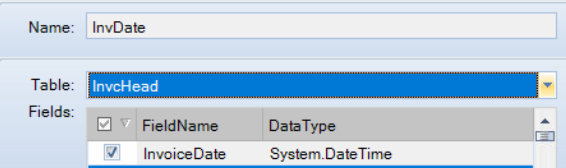

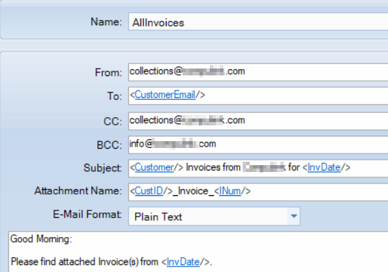

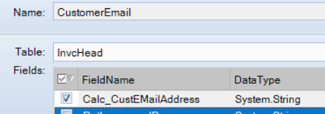

@NateS Here is a sreen shot of ours that does both based on what the customer or their automation software wants. If you only want to break by customer then add the break and then only pick custnum.

First Add Breaking by CustNum and InvcNum.to get individual invoice PDFs - Attach to DocStar if you have it.
Then add a Group By of CustNum
Then add a Send Email.

Also, how did you setup the Email Widget?

Group > Print Invoices. We first emailed ourselves and I had the customer email in the body and accounting would review the invoices and then forward them. Then they were comfortable enough that we moved to direct to the customer.
