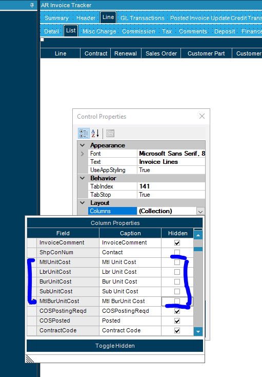

It will be ideal to use the cost fields available in the invcdtl table.
In the invoice tracker we can use the personalization to enable the unit cost.
If total needed then it can be calculated through customization.

When the invoice is created it is referenced to a shipment, it will pick up the cost from the shipment (customer shipment entry).
Standard or avereage is depends on the costing method.
@ypgpatel
Add new field for the Total cost.
Calulcate the total cost through customization or BPM, when the new line is added / updated.
Total Cost = (MtlUnitCost + LbrUnitCost + BurUnitCost + MtlBurUnitCost) X ShippedQty
