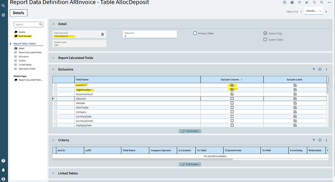

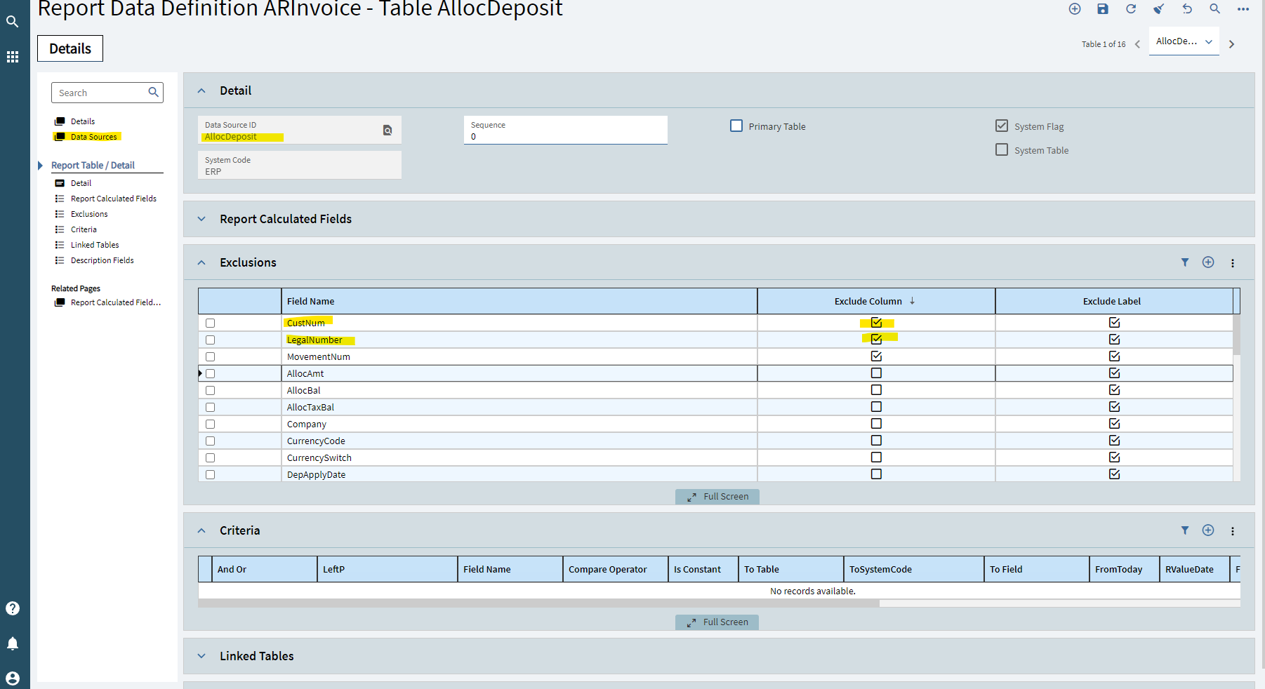

Hi All,
Can someone with Epicor version 2024.1.7 or higher, please share the screenshot of exclusions grid from AllocDeposit datasource of ARInvoice report data definition.
Basically I am looking to see if columns “CustNum” and “LegalNumber” are marked as exclude column in Epicor version 2024.1.7 or higher.

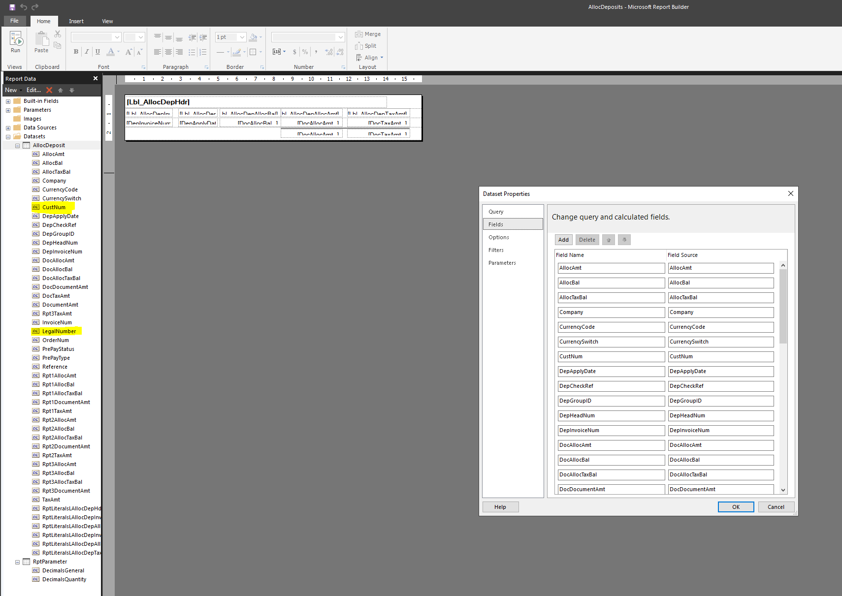

My AR invoice report is showing error for sub report linked to this datasource, and upon checking i found that these fields are there in the SSRS file but in data definition they are marked as excluded.
