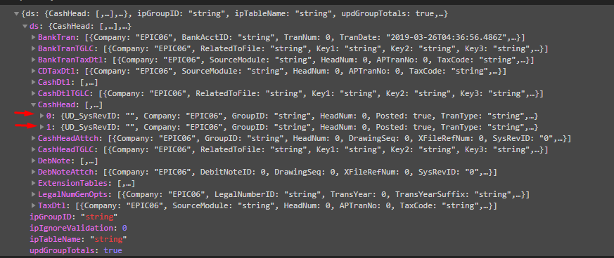

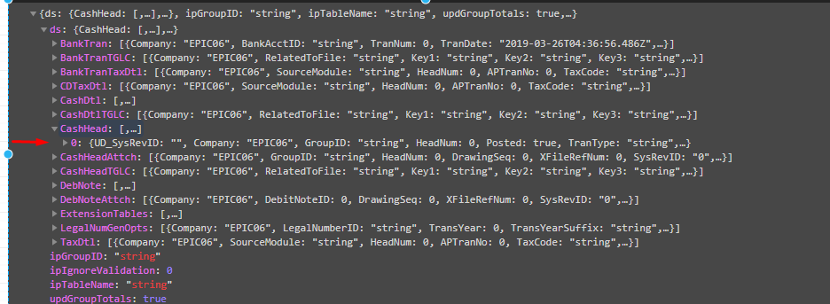

In your API transaction based off your trace you are sending through the row to update or create to the Update master method like so. This row would be RowMod = “A” or “U” (Add / Update).
However for an UpdateMaster you need to firstly duplicate the row so there are two rows of the exact same data like this.
CashHead[0] should have RowMod = ‘’
CashHead[1] should have RowMod = ‘A’ OR ‘U’
The transaction you are doing should now work through the REST API (assuming you followed the trace exactly).

That worked! I did not know that about the UpdateMaster call, but gave it a few tests and everything worked perfectly:
  "ds": {
    "CashHead": [
        ***The Cash Head data here***
    "CashHeadTGLC":  [
        ***Unmodified data for entry***
        ***Modified data here***
