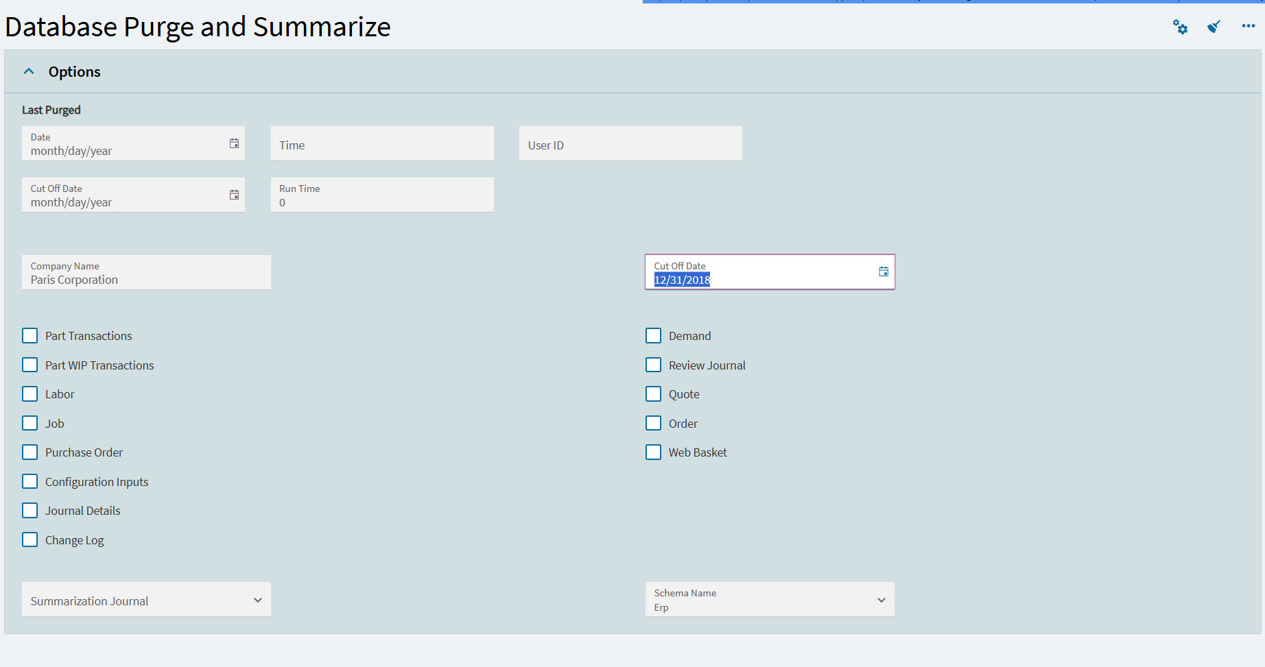

Epicor has a built in Purge and Summarize feature that can be run once in a while (I’ve never tried it)

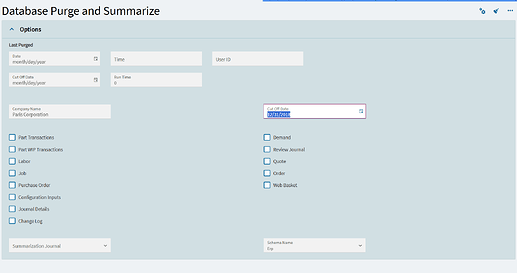

Screencap of the prompt screen in case anyone’s interested. No, I didn’t click the Gears button in the middle of a Friday…though I was TEMPTED
It seems to me the purge feature was put in when they launched E10 and was really designed to be run only during upgrades. I think the comments I remember from back then pertained to those users who had been on Epicor for quite some time by that point and having a decade+ of records that would need to be uplifted from Progress to SQL. I don’t think it was something that was intended to be run as a normal thing.

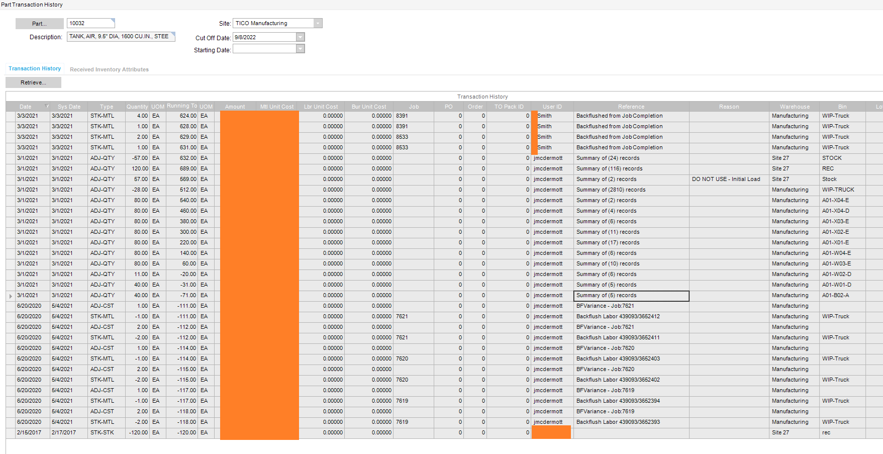

Found my notes. I tried it in 2022.
I tried 4.3 years’ worth of transactions. I cancelled it after 17 hours, where it was approximately 10% through the PartTran records.
So that extrapolates to a literal week of processing.
You’d have to do like 3 months at a time, every weekend or something, for months till it was done.
EDIT:
Here’s the screenshot I took then.
- Again, I cancelled the process well before it finished. Fair warning.
- Cutoff was 3/1/21
- This is a VERY common part here - we have transacted it basically every day since December 2016
- You can see some of the summaries - they are all dated 3/1/21
- Most of the original transactions are gone, but there some oddballs that remain from June 2020.
