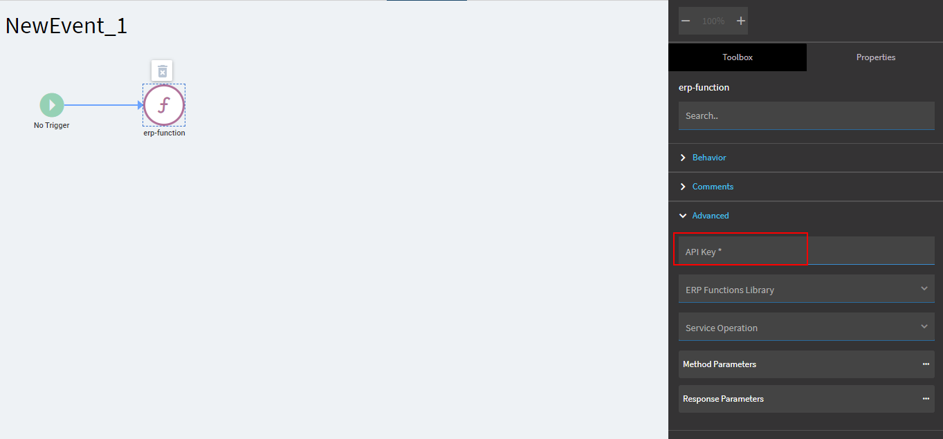

Then moving my library to production. I couldn’t figure out why I was getting error 401. I didn’t realize I had to make a whole new API key in the production environment, and then manually find every single instance of my functions in the layer, and manually update the key in those events. Really?? This is so nuts I can’t believe this is correct.

For example, I have an event that is calling a function in sales order entry. Its requiring me to enter my API key in the configuration of that component.

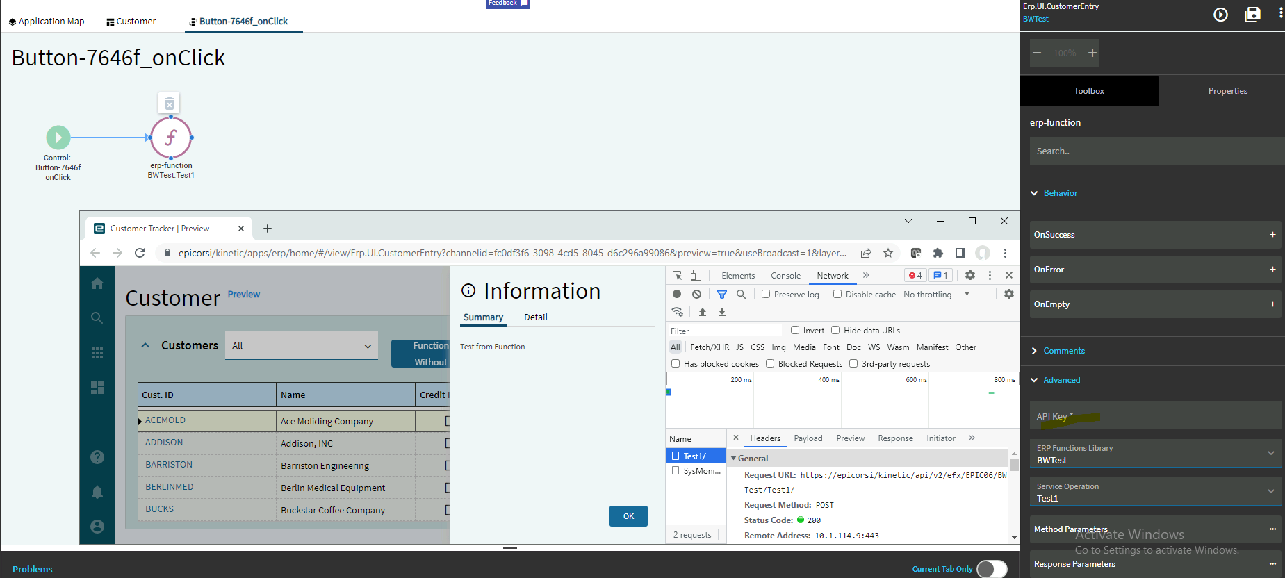

In terms of the API key in Kinetic Layers. Do note that in recent versions the API Key is not required to call a function in a Kinetic layer. Application Studio still shows it as a required field; however, it can be left blank and will still work. This is definitely the case for 2022.1. Not sure about 2021.2 I’m afraid. It is still required when calling outside the application.
I have just tested this in 2021.2.6 and it is the same new behavior
Really? Why?
Session header is sent automatically by homepage
