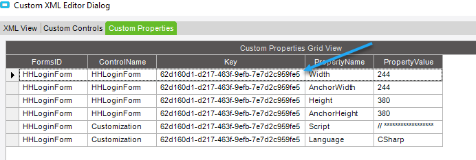

I’ve been trying to work through a problem where some hand held forms don’t appear to allow customizations to stick. What I have noticed is that the GUID of the form changes every time you open and close the form. For those a more intimate knowledge @Bart_Elia @Rich et al is this expected behavior?
Here’s some screenshots

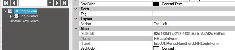

First entering a new customisation

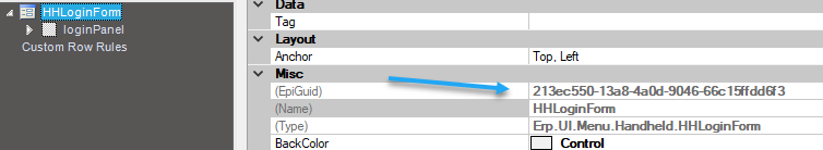

After making a change and saving
After closing and reopening

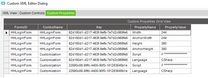

Adding some code
After closing and reopening a second time
When I look at the BinTracker form for example and open and close it the Form GUID does not change. I am wondering if this behavior is the cause of customizations not sticking from the time of creation, saving to closing and reopening.
