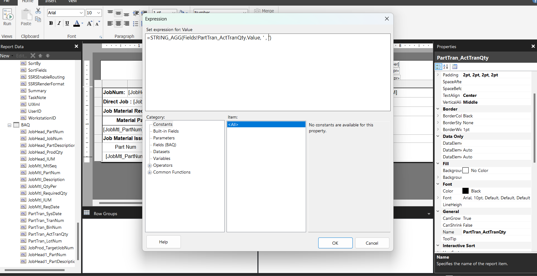

Are there any functions that can show data in columns?
STRING_AGG perhaps.
There are rules you can put in place in every single cell to hide them. It the “Hidden” expression. If your expression returns true, then the cell will be hidden. This may help! In the hidden expression for those cells, simply say if null then 1, else 0. You may have to play with the syntax. Good luck!

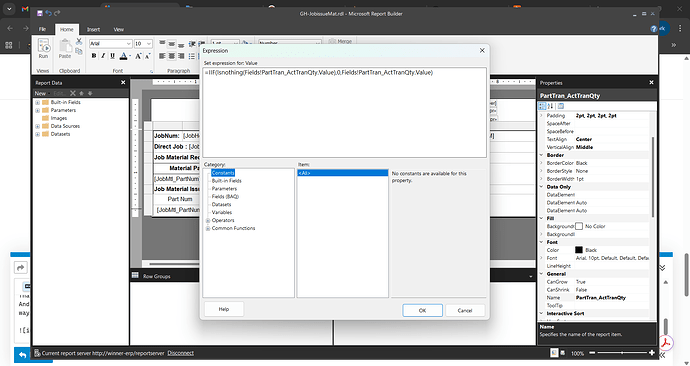

And if I want the sequence of given data to be consecutive instead of 0, is there a way to do that?
Why not update the BAQ to SUM those to only have a single value after the partnum?
I don’t understand the request.
Tee, you would need to take those results in this post that I’m replying to and make a subquery of them and then sort them by the qty column and add a calculated field called RowNum(over your sortby column) then join that subuery back to that original table you have on partnum or whatever and then sort your columns by that new field you just made in your subquery.

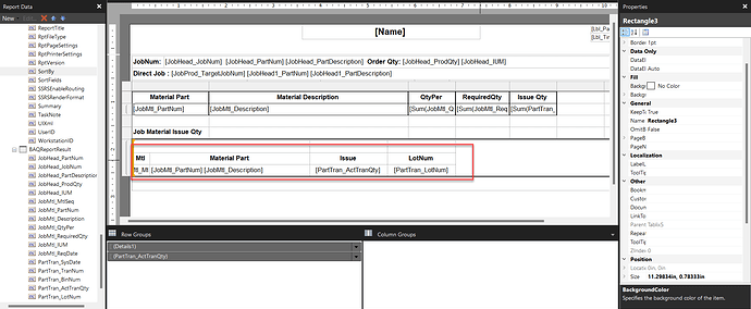

I’m coming up with this off top of my head, are you using a tablix or a matrix in SSRS?

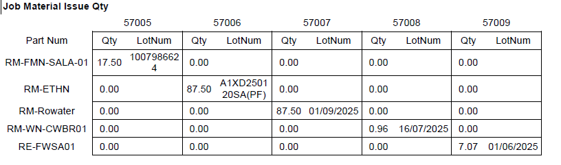

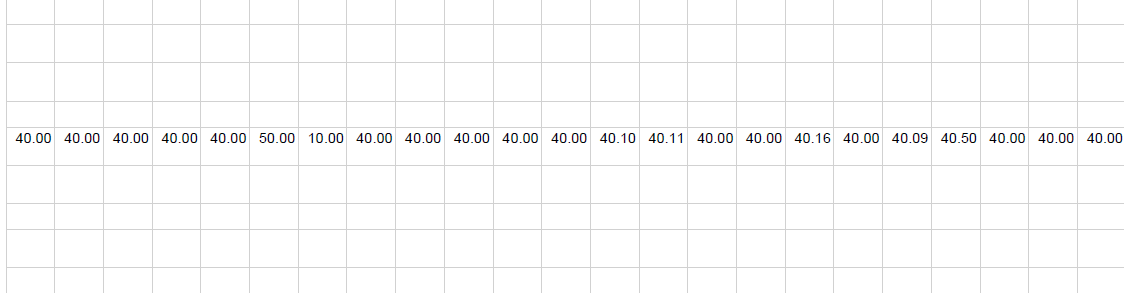

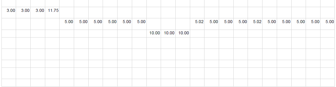

Example of the Report Issue
But I want the report to come out like this.

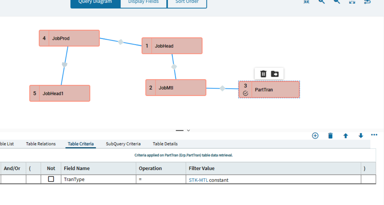

My BAQ
select
[JobHead].[PartNum] as [JobHead_PartNum],
[JobHead].[JobNum] as [JobHead_JobNum],
[JobHead].[PartDescription] as [JobHead_PartDescription],
[JobHead].[ProdQty] as [JobHead_ProdQty],
[JobHead].[IUM] as [JobHead_IUM],
[JobMtl].[MtlSeq] as [JobMtl_MtlSeq],
[JobMtl].[PartNum] as [JobMtl_PartNum],
[JobMtl].[Description] as [JobMtl_Description],
[JobMtl].[QtyPer] as [JobMtl_QtyPer],
[JobMtl].[RequiredQty] as [JobMtl_RequiredQty],
[JobMtl].[IUM] as [JobMtl_IUM],
[JobMtl].[ReqDate] as [JobMtl_ReqDate],
[PartTran].[SysDate] as [PartTran_SysDate],
[PartTran].[TranNum] as [PartTran_TranNum],
[PartTran].[BinNum] as [PartTran_BinNum],
[PartTran].[ActTranQty] as [PartTran_ActTranQty],
[PartTran].[LotNum] as [PartTran_LotNum],
[JobProd].[TargetJobNum] as [JobProd_TargetJobNum],
[JobHead1].[PartNum] as [JobHead1_PartNum],
[JobHead1].[PartDescription] as [JobHead1_PartDescription]
from Erp.JobHead as [JobHead]
inner join Erp.JobMtl as [JobMtl] on
JobHead.Company = JobMtl.Company
and JobHead.JobNum = JobMtl.JobNum
inner join Erp.PartTran as [PartTran] on
JobMtl.Company = PartTran.Company
and JobMtl.JobNum = PartTran.JobNum
and JobMtl.PartNum = PartTran.PartNum
and ( PartTran.TranType = 'STK-MTL' )
inner join Erp.JobProd as [JobProd] on
JobHead.Company = JobProd.Company
and JobHead.JobNum = JobProd.JobNum
left outer join Erp.JobHead as [JobHead1] on
JobProd.Company = JobHead1.Company
and JobProd.TargetJobNum = JobHead1.JobNum

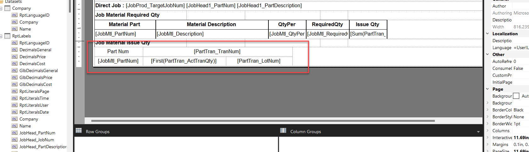

I finally looked at the query and yeah that’s what’s happening, they have parttran only joined by part number and job number

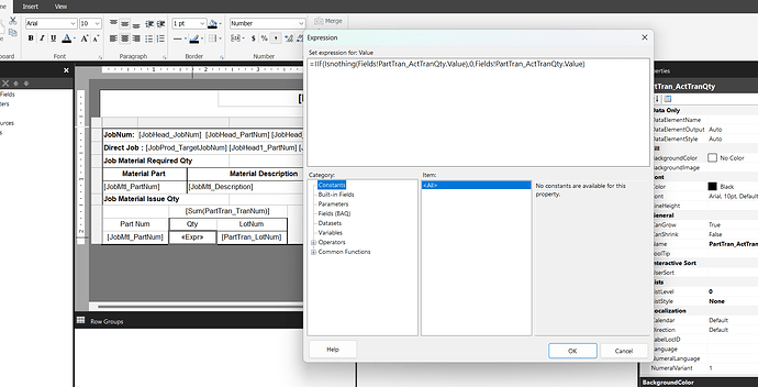

Looks like he’s pivoting by TransNum and wants to keep that detail and shift so must pivot by transnum rank instead.
Add this column to your query then use it in place of TransNum on the report.
ROW_NUMBER() OVER (PARTITION BY JobMtl.PartNum ORDER BY PartTran.TranNum) AS TransRank
Yes, I separate them by Transection to make a separate report for each issue material.
