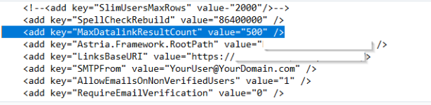

If datalink is set to go to line items and only 100 line items are showing - make the following changes
If datalink is set to client:
go to C:\Program Files (x86)\Astria Solutions group\Eclipse Client Service\Astria.client.windowsServices.automationservice.exe.config
add this line under the AppSettings header
make it the value you want
restart the automation service
If this is set to server:
C:\Program Files\Astria Solutions Group\Eclipse Server\web.config
Just in case others don’t have that line in theirs, would you be able to add the line of code as well as a snapshot of the .config file where it goes? This could very likely help others experiencing a similar issues. Thanks in advance, Barb!
