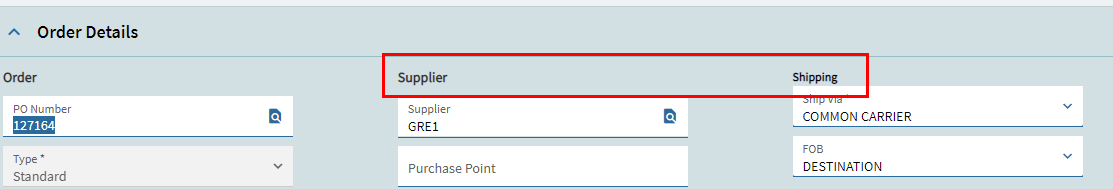

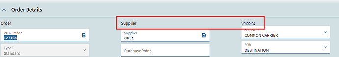

I was trying to begin some simple Kinetic customizations since we are still on classic view. But the first one I tried, when I added a new group on my form, the font for the group label I added is noticeably different than the font on the native group next to it and there are apparently no font controls at all? How are people using this? I would accept the lack of styling options if the controls I added at least matched what was on the screen but they don’t. It also seems impossible to copy and paste an existing control?

Regarding your original font question, it likely has to do with what control you put that label on. Like–look at theirs. It’s probably it has a container within the group and they have the text on the outer one or something similar.

I did set it up identically as far as I could tell, but I will take another look and try again, thanks for the suggestion.

You were right - they had the label on the div not the container and I totally missed it, thank you!!!
