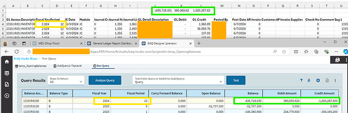

First, a tangent about what works like I expect. Here is a random account. Ref picture below.
  • In the spreadsheet, I sum up all GLJrnDtl transactions for FY 2024, period 12 (that was June 2024 for us)
  • In the BAQ, I am looking at GLPeriodBal
  • The numbers match. Hooray. (Green boxes)

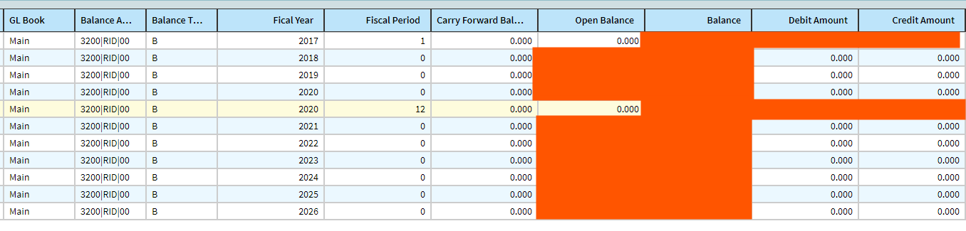

I tried to do the same thing with our Retained Earnings account. But I have almost no GLJrnDtl activity for this.
Period balances:
ALL of the detail in my test database (where is 2018, 2019, 2021, etc.?):
