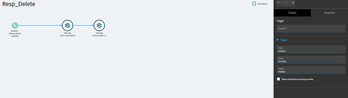

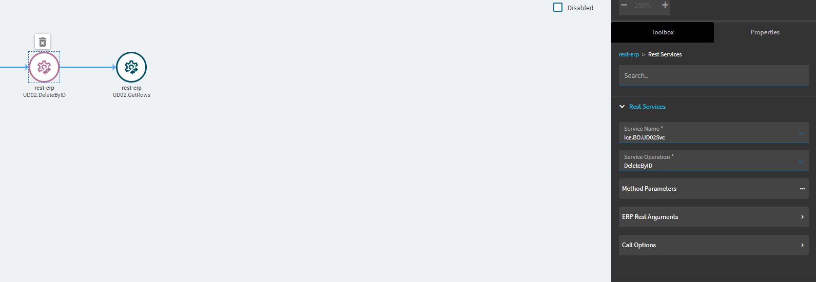

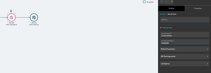

rest-erp with DeleteByID, with {UDxx.Company}, {UDxx.Key1}, {UDxx.Key2}, {UDxx.Key3}, {UDxx.Key4}, {UDxx.Key5} in the parameters, followed by a GetRows should work.

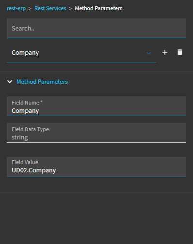

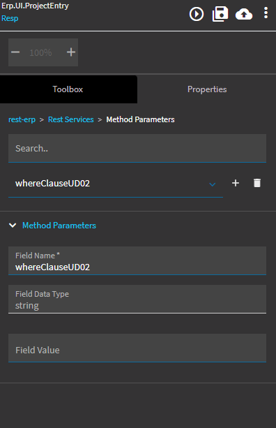

I setup the following:
However I get the following error:
Company through to Key5 is setup correctly
This:

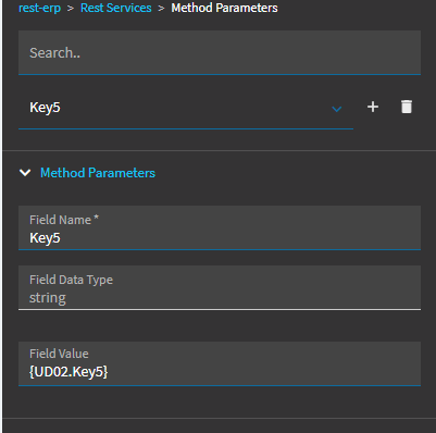

Should be enclosed with { } as in my previous message, then it will work. Enclose the “Field Value” for all parameters in curly braces. This tells AppStudio to “Look up the variable and replace it with the value”
My sincere apologies,
This has been rectified however the same error remains
Try with “{UD02.Key5}” - might work then - what do you see in the network trace (F12 Dev Tools) being sent in the network tab, under payload, when you trigger the event?
Edit: I am assuming that you have a DataView created named “UD02”, and that the row you want to delete is the currently selected row in that dataview

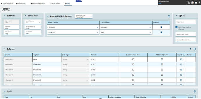

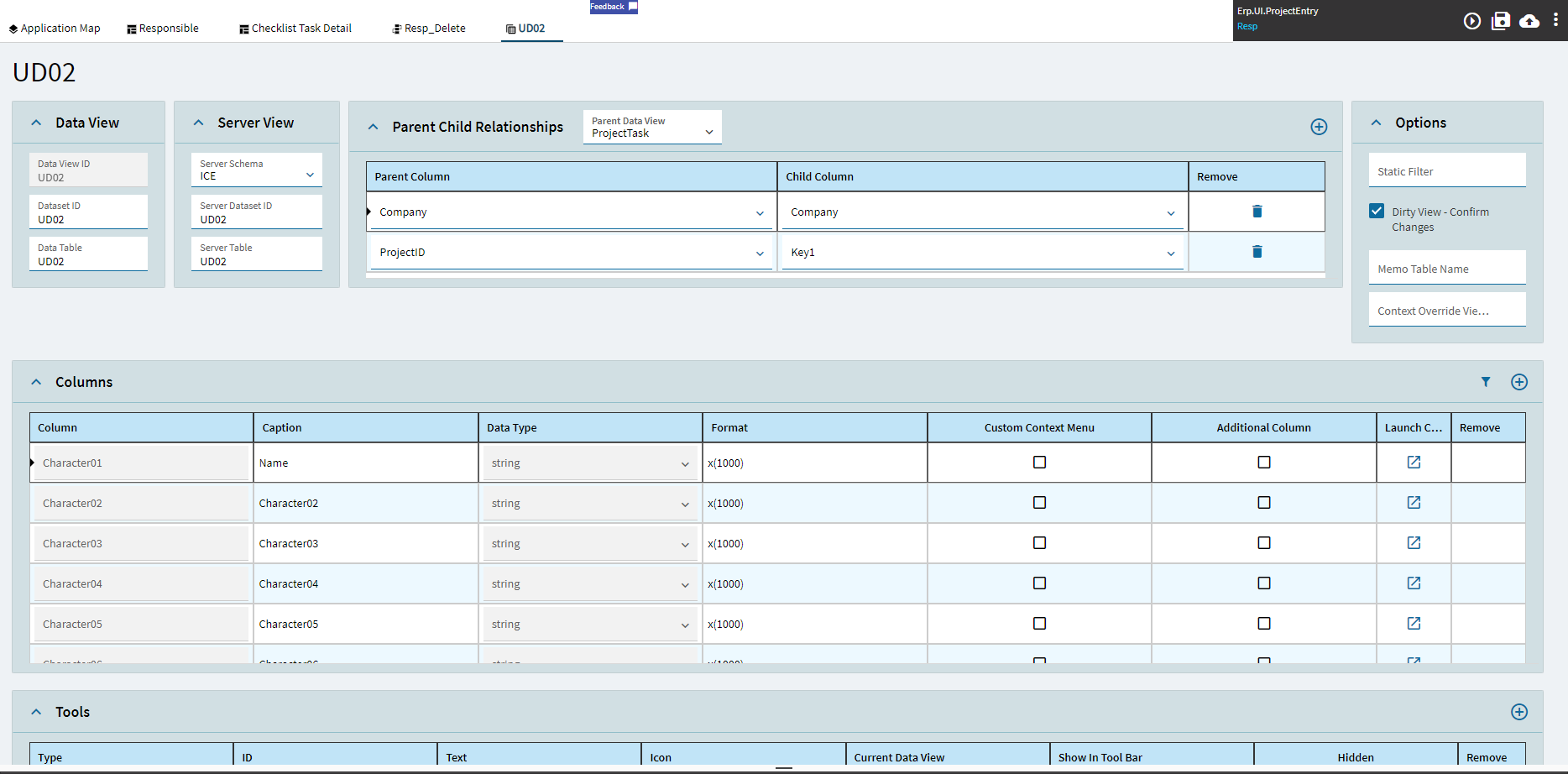

Ok so the data view is named UD02.

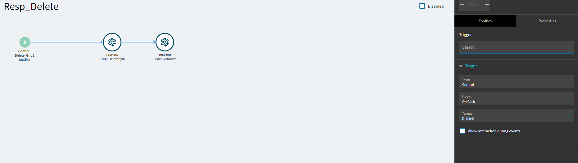

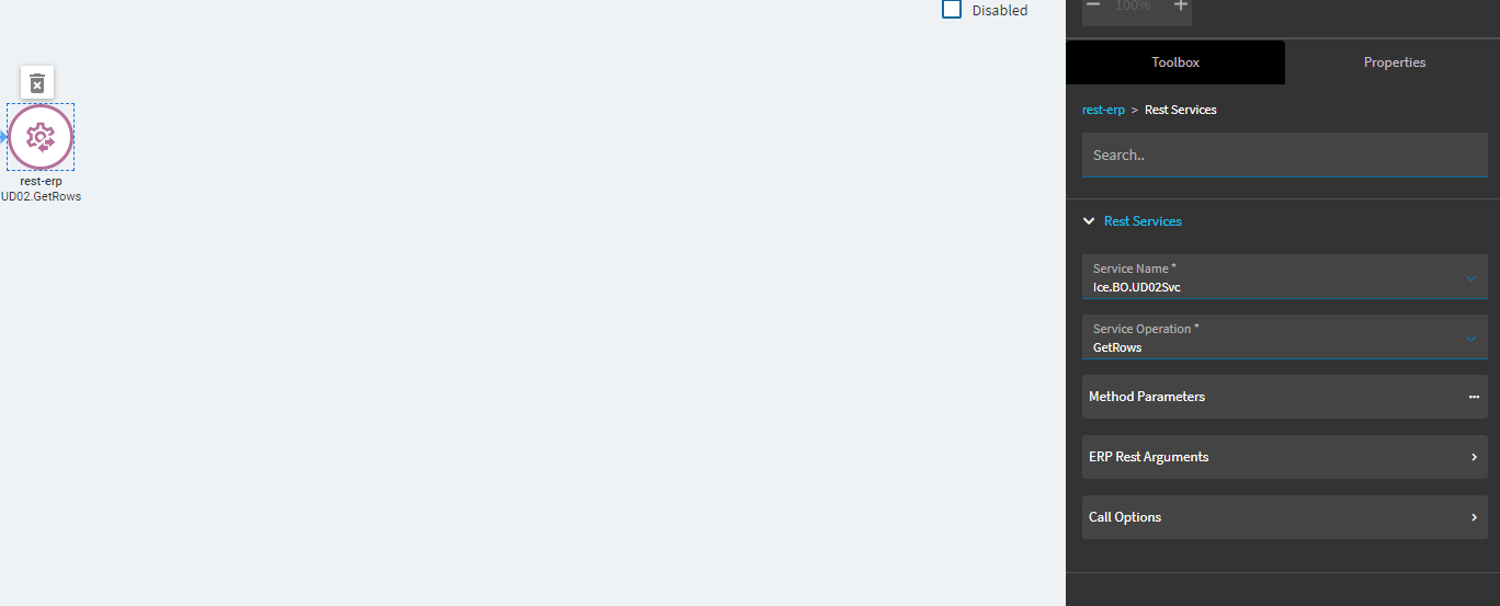

It’s attached to the Ice.BO.UD02Svc like so:

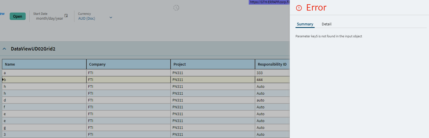

Then this data view is attached to a grid. when i click on an entry and click the minus button on the grid I receive the error im mentioning:

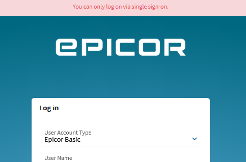

Ok so I gave this a try, My understanding is that im unable to do this as my manager has enabled single sign on that uses my computers credentials to sign me in. Therefore I am unable to login to it. He is on leave at the moment so im unable to work around this.
Would be nice to have debugging tools lmao
Believe so. If you’re unsure as to how to help it’s ok I understand my specific case is rather constricting lmao
If SSO is turned on but not enforced, you might have a drop-down on the web page to switch to Basic auth vs. SSO, try that. If not, you can enable the same debugging tools within the Smart Client, it’s just more of a pain to work with than the Web Browser.

Well SSO is enforced:

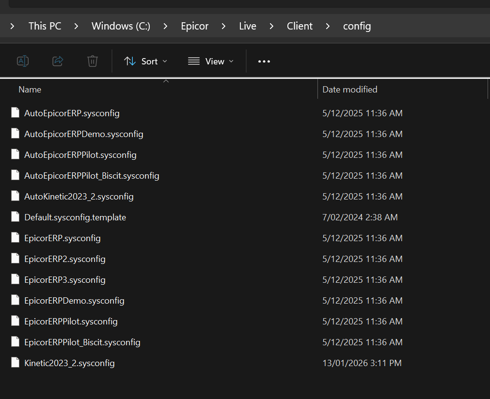

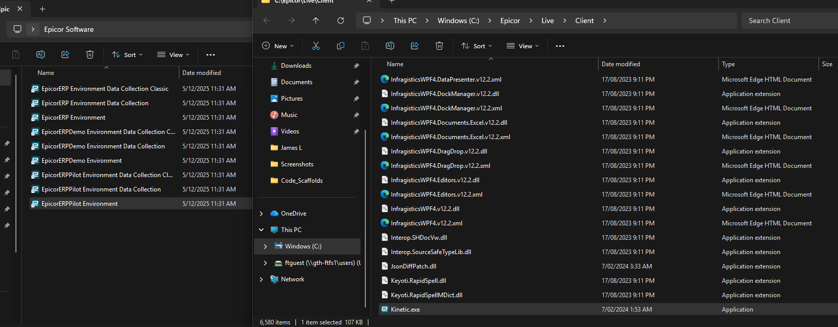

I then went ahead and followed the steps on turning on EO Browser.
Inserted those two lines, saved the file, relaunched epicor. Nothing appeared even after i opened project entry and went into Application studio.
This was the file path:
Epicor really doesn’t seem to like me
Edit: That was the Live folder (Think i found my mistake)
Edit2: I dont have any other folder other then Live(Is debug not appearing beacuse im on Pilot
Yes, from what you are showing, it appears you are modifying the sysconfig for live, but launching pilot.
Right click the shortcut you are using to launch pilot and go to properties - it should show the folder it’s launching from.
Shortcut Links to the live file location. Weird . . .
Edit: its a different config file, fixing now

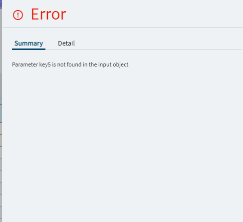

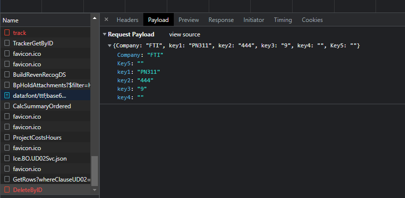

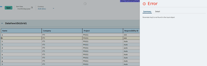

Sorry for the wait, was getting my head around the debug tool. This is what I get when I run it with Company through to Key 5:
and im getting the error: Parameter key5 is not found in the input object.

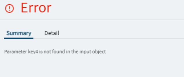

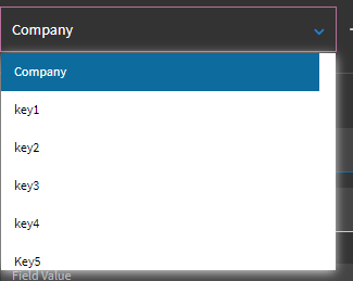

So then I removed the empty fields from DeleteByID Parameters (Key4 & Key5) so I had Company through to Key3 and now got this error:
My understanding is that no Key field can be null?? However for the UD02 table im using i did not need another 2 Key fields so i didnt want to add 4 and 5. however deleteByID needs all Key Fields to work . . . ???
No worries, knowing how the debug tools work is very helpful to all future development, it is worth the time :slight_smile:
Note the case in your payload object. The fields are case sensitive.
It is a requirement to include company and key1-5, you can’t omit any.
Key5 is capitalized correctly, change the rest to match and this should make it work.

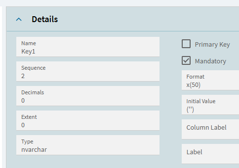

You are correct - no keyfield can be null. Key1-Key5 are string, with default value of empty string “” (Check Epicor’s Data Dictionary on UD02) - so any unused KeyX field should be sent as an empty string.

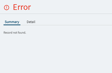

10 Points, what a slip up on my end, but why can’t the record be found now?
Maybe it was deleted in a previous attempt? Validate that it is still there.
Check what was sent in the debug tools payload - compare this against a BAQ run against UD02. Any difference on Company, Key1-5?
