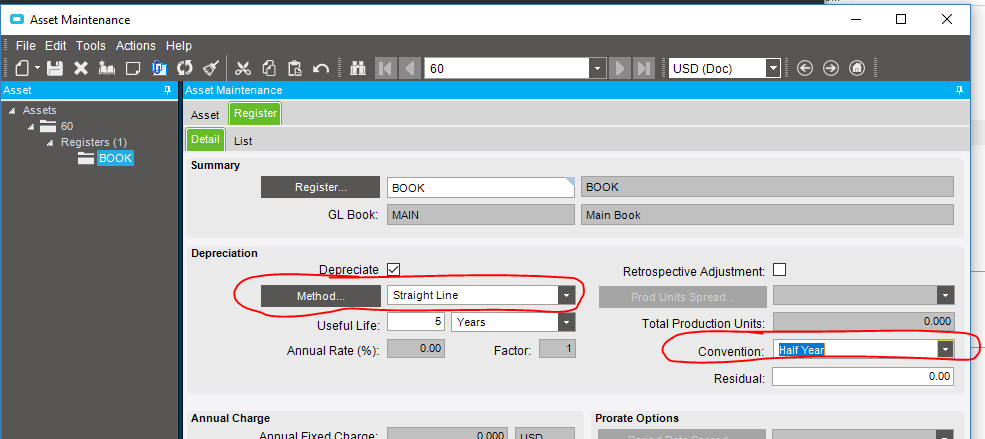

We are using Straight Line Half Year (coming over form SAGE FAS) but do not see a way to create this formula using the custom method . Do you have a way to create this formula?
Hi Ed
Hope all is well
If I read your question correctly, I think you could just get away with using straight line and a convention of half year. No need for a custom formula

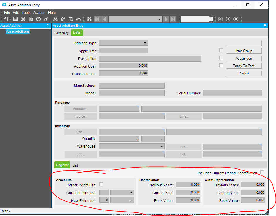

The recommendation worked. However, the problem we have is how to import partially depreciated assets (we are importing form FAS)? The only way we get anything to work is to set the INTERGROUP flag to TRUE and we also have to have a value in CurrentCostValue field. This then inflates the total for the depreciation schedule by this amount (Book value is fine though). If you leave it BLANK then it won’t do anything. (perplexed). The only option I can think of is to try a DMT for these assets instead of just the IMPORT from the menu bar.
Hi Ed
We are converting from Lawson but I don’t think that matters.
Yes, you are correct. In order to load Asset “beginning balances”, they MUST be loaded as Intergroup additions. I would suggest that you use DMT but you don’t
have to. Ifyou check the intergroup checkbox, the Previous years depreciation boxes will light up and allow you to enter that data. When I was testing, I just did it using the entry screens. You do need to have fiscal calendar that goes back to the earliest
asset acquisition date. I had to create calendar entries going back to 1999. I argued with Epicor over this because it didn’t always work this way, but it does now.
