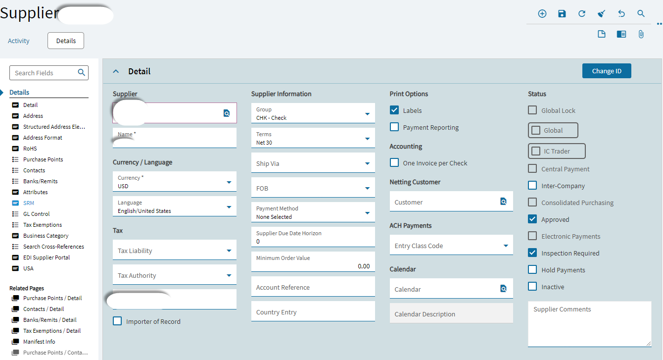

I must not understand the question. I went into supplier maintenance and have a primary supplier dropdown to select what buy is assigned to that supplier.
what version of epicor?
In my Pilot instance on 2024.2 i dont see what you are describing
I am on 11.2.300

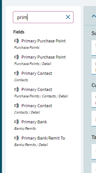

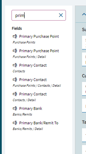

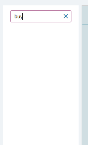

I just checked 2024.2.12 (11.3.200)
I searched for ā€˜Prim’ or ā€˜Buy’ and I don’t see anything.

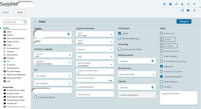

I bet @jmaves has a customization/UD Field.
Yes, it appears that it is a UD field.
Sorry I couldn’t be of more help!
That looks suspeciously custom to me.
With that field selected, select ā€˜Field Help’ from the Help menu and select the ā€˜Technical Details’ section, which will show the DB field.
