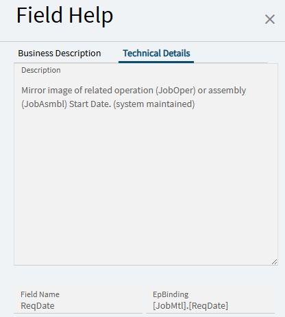

Looks like JobMtl.ReqDate is tied directly to JobOper.StartDate.
I don’t know that there’s any way to break that relationship.

I understand the JobMtl.ReqDate is a managed column, just not sure how to accomplish what I need to save jobs with all associated children JobMtls but allowing for custom due dates on each one.
