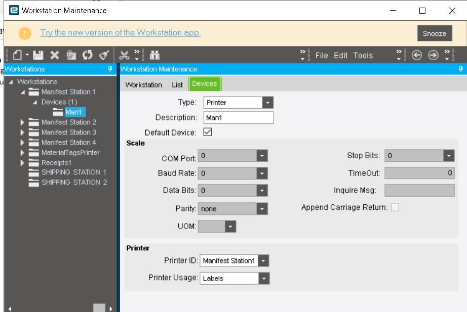

I created a workstation with the following details:
When I went to devices tab, it is greyed out
ATul, when a record doesn’t exist for the screen to display, it’s grey.
Here is a screen shot of one of my setups.
Add an Epicor “Printer” (so it can be selected in the Printer list.
Thanks guys. It worked.
