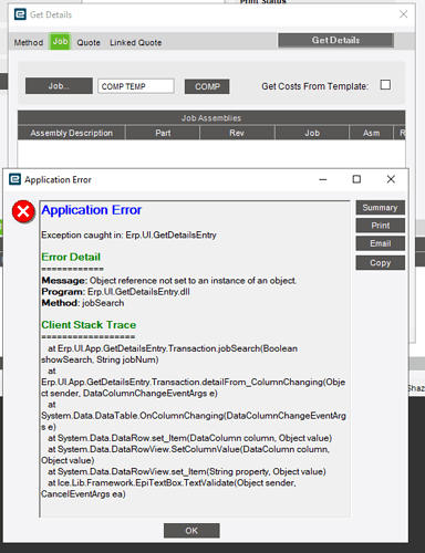

Here I notice something: when I load the (customized) Get Details form from the menu, everything works:
But when I open it from the custom button, I get this error when clicking the custom “COMP” button (which worked the other way) or when I click the Job button to load the search form. Notice the title bar this time doesn’t include the Job number, Asm number, or Part number.
Does the normal way of launching the get details form require passing parameters from the Job ENtry?
