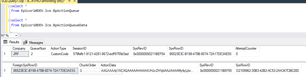

Performed the test with Post-Processing getNewABCCode and same results unfortunately.
Edit: Actually no, it works with ABCCode.
So we can at least conclude, inconsistent results??

Interestingly enough, using a standard Epicor BO like ABCCode with the same test did work as designed, meaning the async code is written to the BpActionQueue and BpActionData tables and the task agent executes when it can.I only preformed the test 1 time, so I’ll assume it works all the time :wink:
