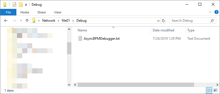

The test I performed was to create a pre-processing BPM on UserProcessWrapper. In the BPM I simply execute a for loop and write numbers 0-99 in a file.
If I set the custom code to execute Synchronously and then invoke the method, I see that it writes to a file without issue.
If I set the custom code to execute Asynchronously and then invoke the method, nothing happens.

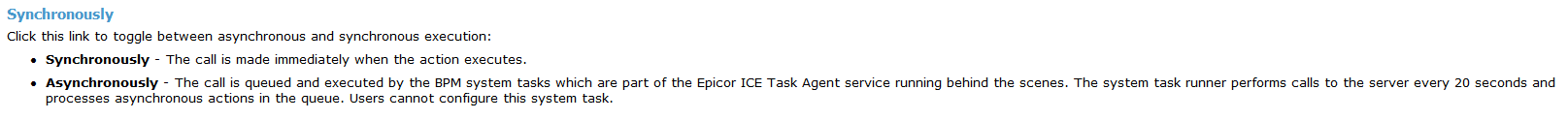

From the Help, the Async. tag on a custom code block indicates the what I described above and that the System Task Runner is responsible for polling those tables every 20 seconds and executing the actions in the queue asynchronously. I’m not sure what the Task Runner is, but I assume its a component of the Task Agent.

So in your case the BPM runs as the app account running the Epicor App Server instance so writing to a network drive is gonna be tricky.

However I’m guessing your issue is a permissions one, try writing to a local file in th C:\ drive of the Epicor server.

I have also tried this test writing to a file on that server, but same results. At the very least I would have expected a record to be written to the BpActionQueue/data tables, so I wonder if this might be a point of failure
