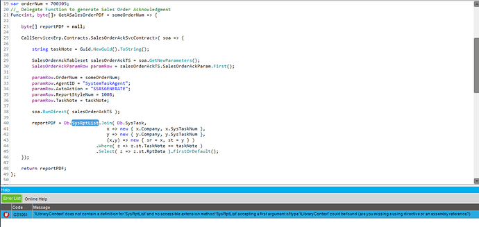

I don’t know if either of you are still looking for this, but since I was referencing @dr_dan 's post to refresh my memory I thought I would pop this in.
Your answer lies in using RunDirect, instead of SubmitToAgent. If you want it to run asynchronously, run it via a scheduled function, which you can schedule on the fly to run “Now”.
Here is the run direct example, which just so happens to be the same report
