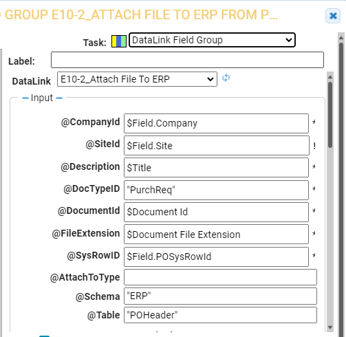

The solution? DataLink with multivalued return → Field Groups → DataLink Field Group.
- The user is prompted to input a comma separated list of POs.
- The value is tested to continue workflow
- Datalink is executed which splits the input string and returns the SysRowID from each PO value.
- Multivalued return is placed into a field group with the 1 field of POSysRowID (though it could be reusable for any process)
- DataLink Field Group “Attach File To ERP” with the field group selected and set to “From” and the SysRowID parameter set as the field in the field group.
