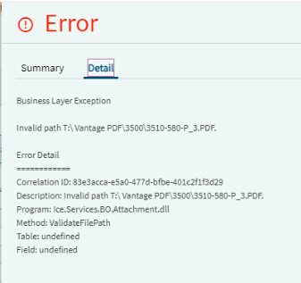

I think this works but I’m getting this error:
Schermafbeelding 2024-12-11 134252
The Vantage PDF folder contains 3 spaces in front but Epicor removes 2 of them.
Does someone know a way to work around this? I cannot simply change the name of the folder because it has consequences for the customer.
Like “Vantage___PDF” ? but _ is a space?
If _ is a space the correct path is “___Vantage_PDF”
Instead of that the method returns “_Vantage_PDF”
