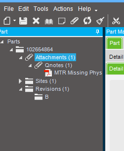

When i ad an attachment to a Part# in Part Maintenance i cant see it in Engineering Workbench.
Eng Workbench:
Is there a trick to determining how to link files in the right spot to see them ?
Eng Workbench:
