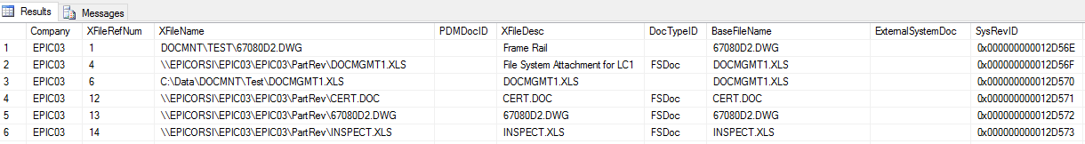

You could create an in-transaction data directive BPM on ice.xfileref where you log the user id of the user that uploaded the file. We don’t have any unused columns on this table, so you might want to extend this table using extended ud table maintenance first so you have a field to write that user name to. This record includes the file name (basefilename) and full path (xfilename) of the attachment that was uploaded so it would be straightforward to figure out who did what when at that point by searching this table (select * from xfileref where basefilename='crazy_large_file_muhahahaha.png' ) - even if you can’t stop a user from uploading it.
