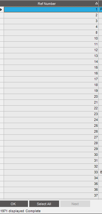

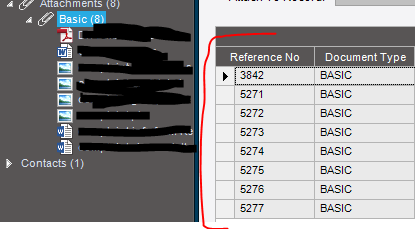

From what I can tell, the sorting of both the tree view is handled by the column Ice.XFileAttach.XFileRefNum in ascending order. In the attachment view, this number will be titled “Reference No”.
I would be curious if yours are also sorting in ascending, descending, or some other order. Can you let me know what order they are sorting in on the Reference No column in the attachments view?

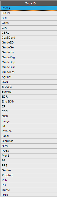

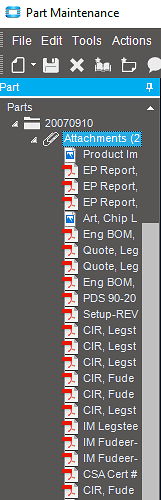

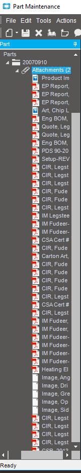

We have document types that we set up in document type maintnence. Our tree veiw used to sort the documents by category. So all images would be in a folder together and the same goes for all the CIR, CSR’s ect and we have it set up this way because we have so many different model numbers and the images ect are different.

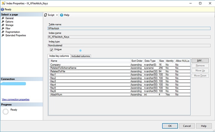

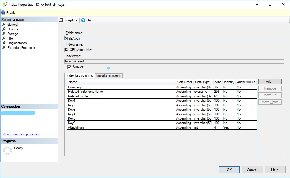

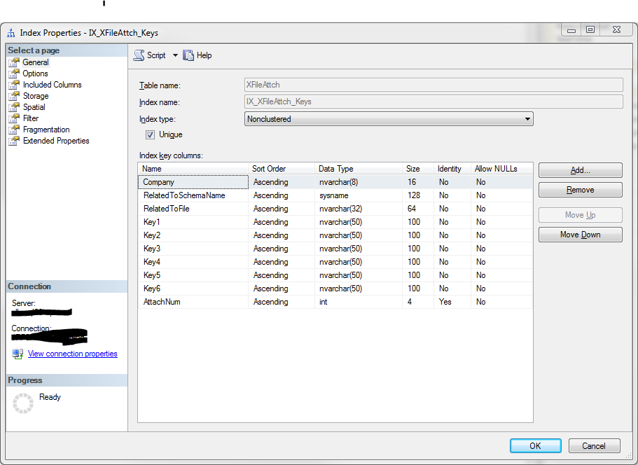

Can you tell me if your Ice.XFileAttch table IX_XfileAttch_Keys index properties looks like mine?

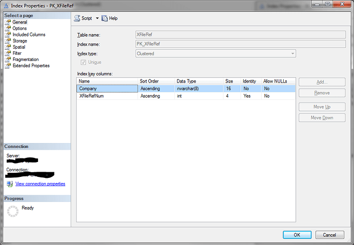

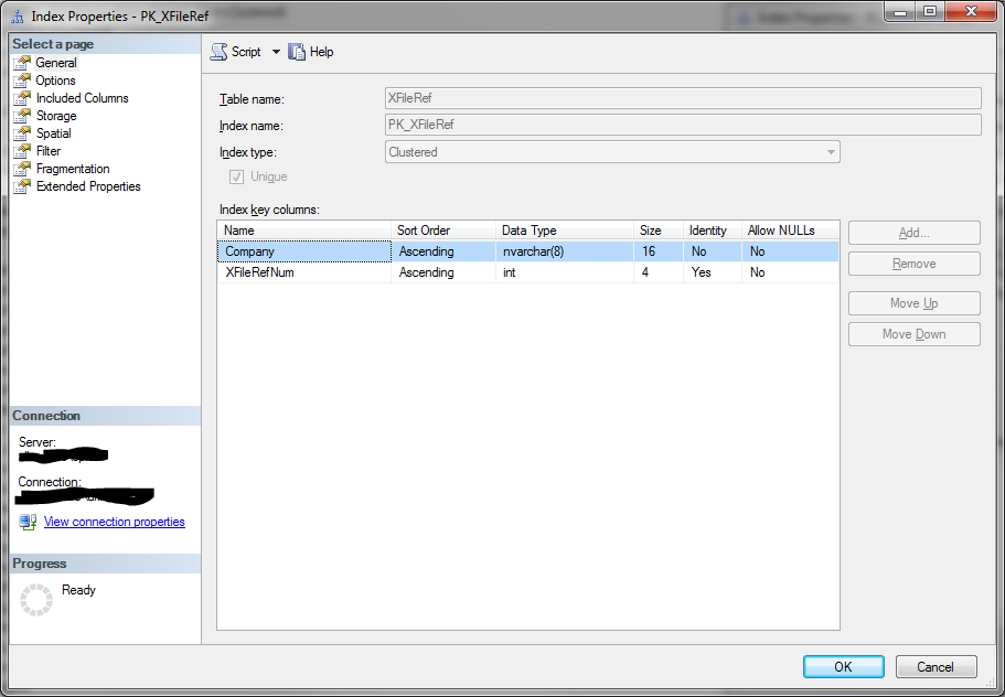

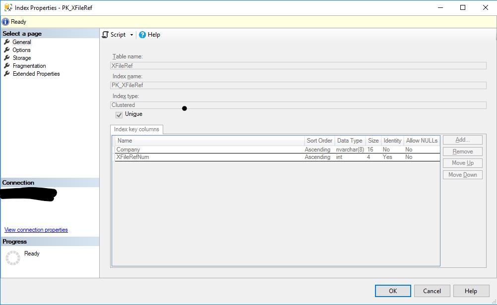

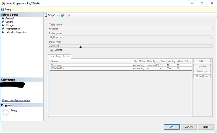

Also this one on Ice.XFileRef PK_XFileRef index properties:
This is what ours looks like. Since we need then grouped could you recommend what we may need to do? Thank you. :slight_smile:
