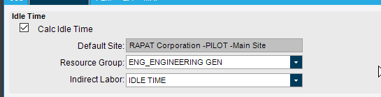

Also, I think there setup options to automatically calculate idle time, so if he just clocks in, but doesn’t start any activity, when he clocks out, I think it will automatically create a labor dtl record for idle.
edit:
it’s in company configuration
Yes, that is all working well. I was wanting his labor to go somewhere else vs the idle time. That way he goes to xxx whenever he is not in an activity.

you can assign an indirect expense at the employee record and then create a resource group you want to use to capture that time. when the employee clocks in have them start indirect activity and clock to that resource.
Great idea. thanks!
